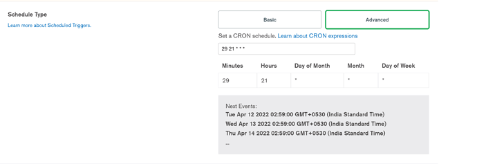

The other important point is the timezones issues, I am in India so I scheduled the Atlas trigger to execute every day +3 hrs from GMT using cron schedule 59 2 * * * but the timestamps are inserted as per Europe/Bucharest timezone of the broker, so the trigger function needs to pay attention to the timezones of the MT5 broker server time as well. I would like to know if I am doing this correctly?
The code for the Atlast Trigger is below, along with the screenshots:

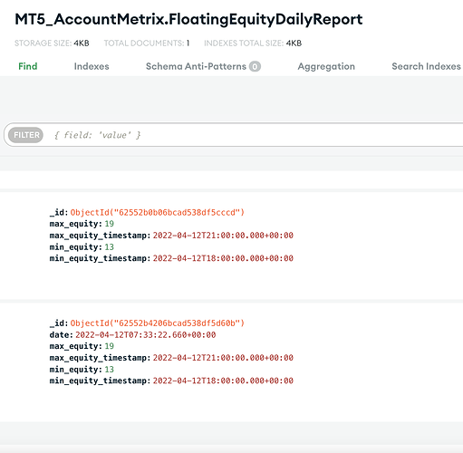

for taking the time to provide the solution. When I run your code I get the following error messages, presented as two cases:
