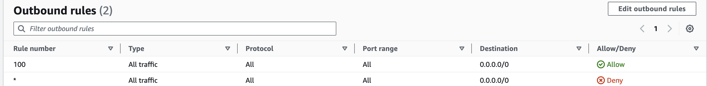

But when I tried to connect with same instance from EC2 instance in private subnet, it’s not able to reach to MongoDB and I get timeout issue. I have ensure all the outbound ports are open with Route table, VPC Security Group, public and private subnet security groups.

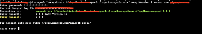

I got Private Endpoint connection string for mongo shell which looks something like:

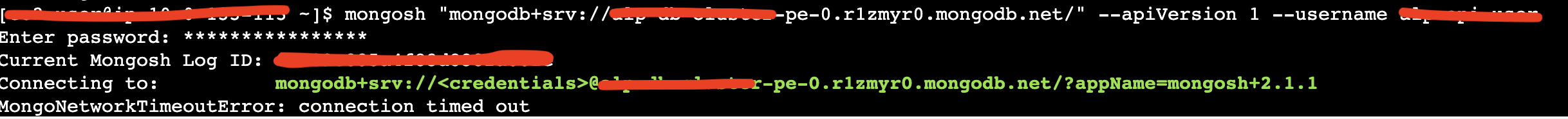

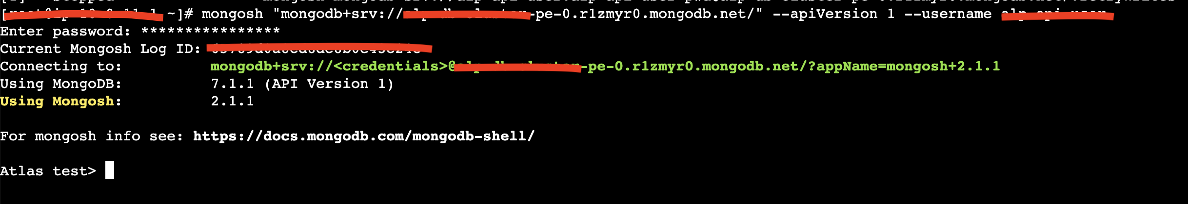

If I use above string in public ec2 instance, it works just fine. But when I tried to connect from private subnet ec2 machine. Attached private subnet machine screen shots. In the next post, I will post screen shot from public ec2 instance

I have tried that before and I tried again just now. I created fresh private endpoint using private subnet id. I used private endpoint connection string and tested using mongo shell but same issue.

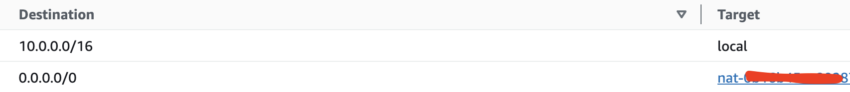

Below is the private subnet route table mapping. I am allowing on IPv4 address.
