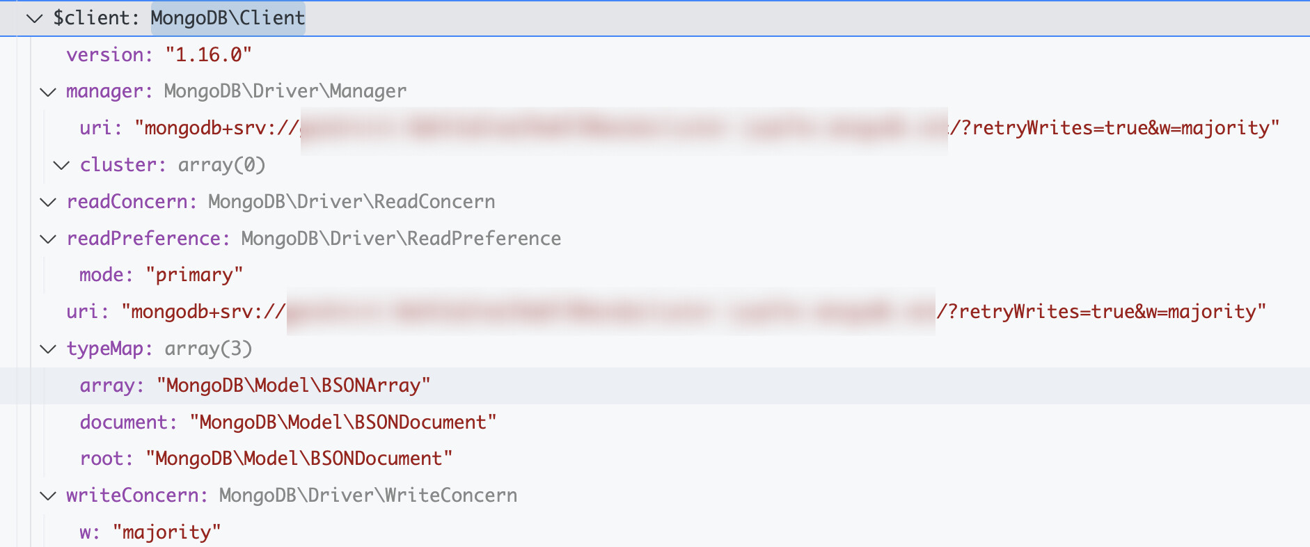

This is what the $client object looks like:

Thanks for the additional data. The client seems to be created OK.
