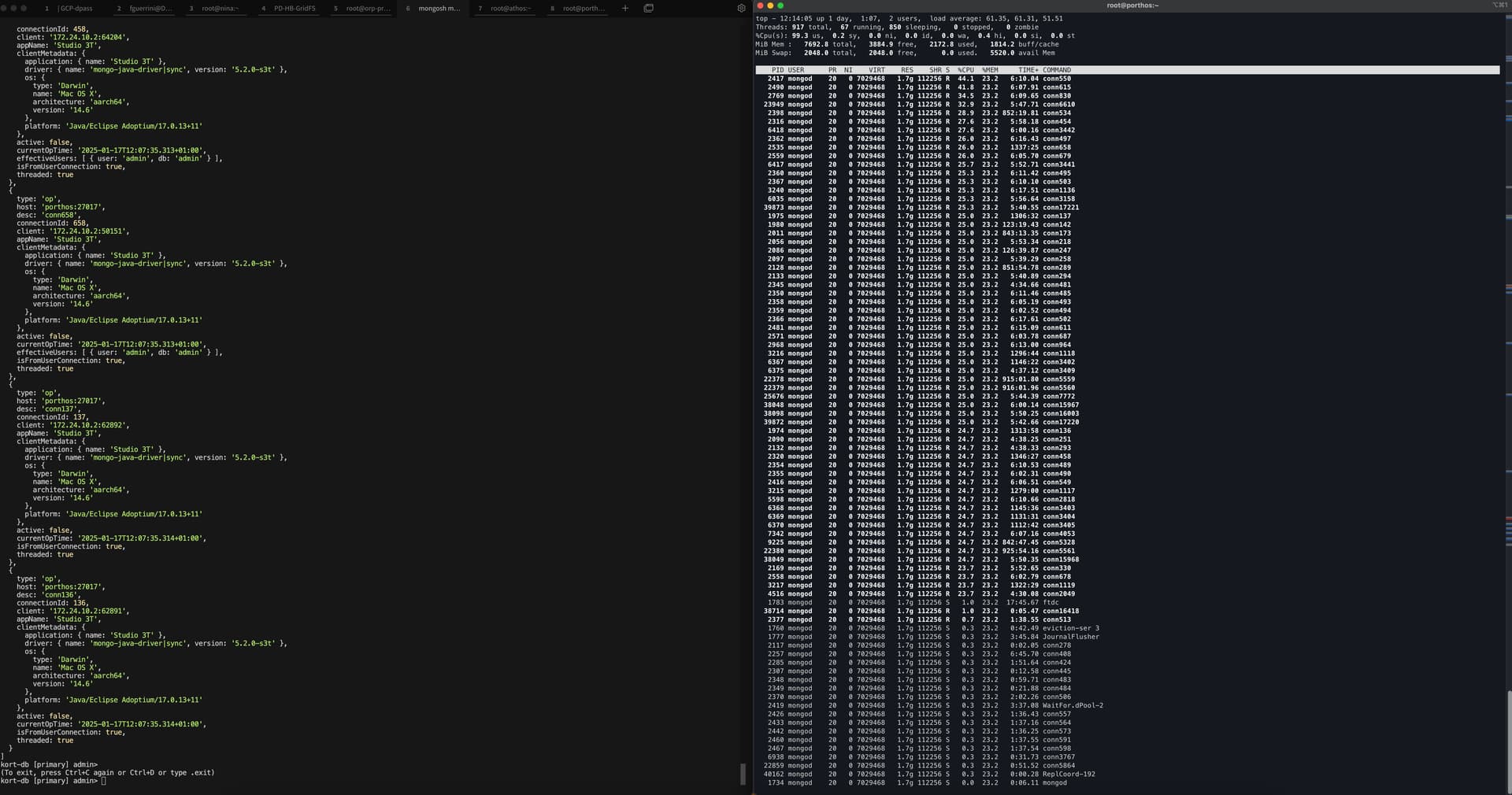

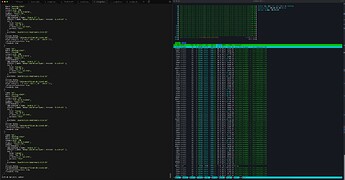

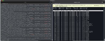

Many stuck connections (top on a specific PID for mongod):
htop view:

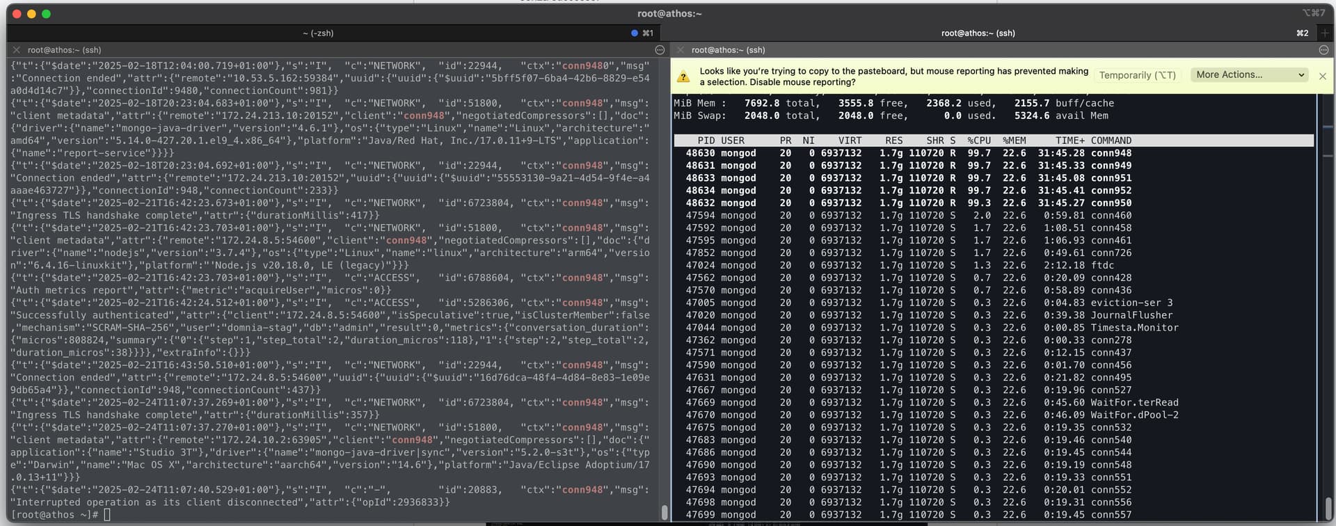

Connection 948 shows as disconnected from the cluster half an hour ago but remains active at 100% CPU:
As you can see with conn948, /var/log/mongo/mongod.log confirms that the connection was closed a while ago.

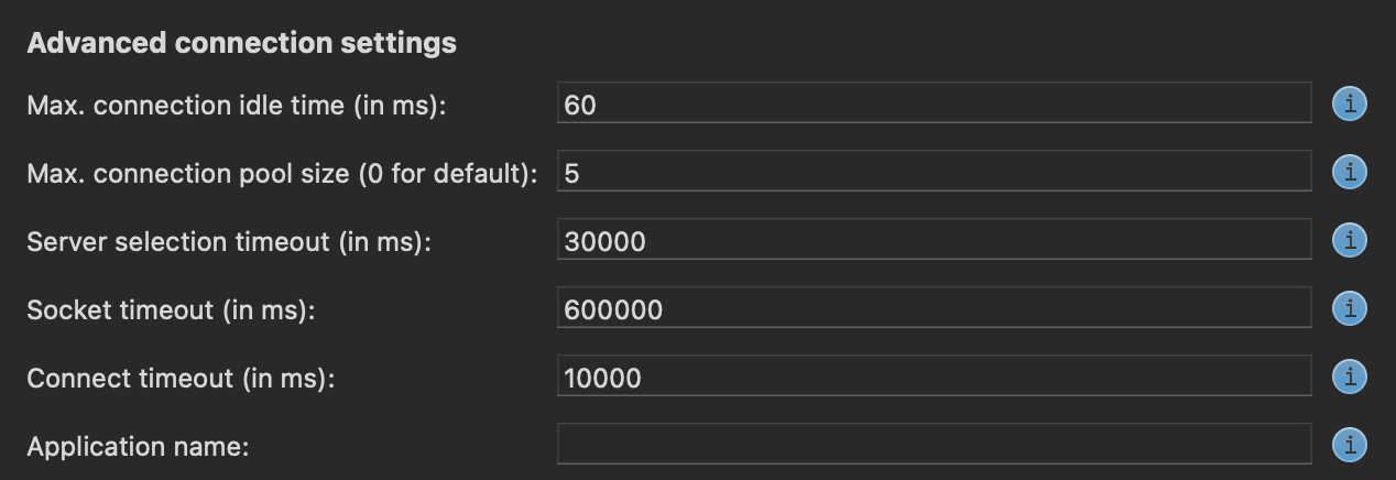

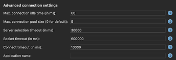

We’ve noticed the Studio 3T client on macOS immediately leaves these connections stuck. Simply open and then disconnect (with the official “disconnect” option) from the replica set: the connections remain hung, each at 100% CPU. Our connection string looks like:
