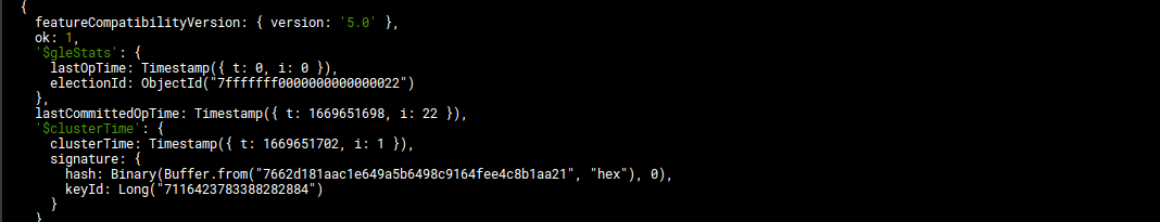

Was this a fresh installation of MongoDB server or were you upgrading from an earlier version?
Can you check the version of the MongoDB deployment you are connected to using the MongoDB shell:
db.version()
… and the featureCompatibilityVersion (fCV):
db.adminCommand({
getParameter: 1,
featureCompatibilityVersion: 1
As you noted, Sharding a Time Series Collection is supported in MongoDB 5.1+. Both of the above commands should report a 6.0 server version.
Stennie
Thank you! This was the solution:
before i had this version, then upgrading with:
db.adminCommand( { setFeatureCompatibilityVersion: "6.0" } )
has worked like a charm!
Thank you a lot
