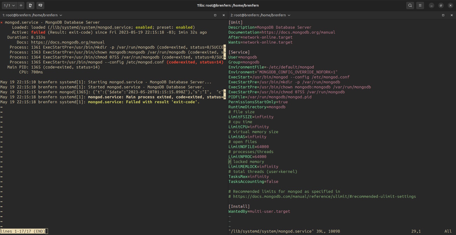

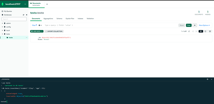

Hello, I’m having problems with my mongod, every time I restart the machine, systemctl doesn’t start the mongod process automatically, in addition to deleting my pidFilePath: /var/run/mongodb (I imagine that the mongod process doesn’t start because that reason). After I start the mongod process manually (after having created the pidFilePath again), I can perform operations normally, but the status of mongod.service remains as failed. Is there a way to correct such an error, what consequences does it bring?

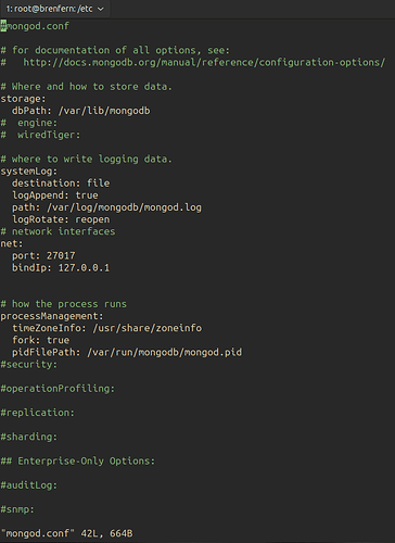

Hi Steve, first of all I would like to thank you for the reply, as I was able to make some headway on account of this post. But, I have a new error, systemctl is not able to start the mongod process through mongod --config /etc/mongod. I’ve already tested uploading the mongod.conf manually to validate the configuration file and it worked, so I think the cause of the problem is not the file. Do you have any more information or ideas? @steevej
You need to look at the log file for error description.
