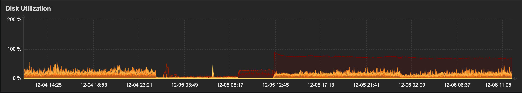

I have an installation with three shards (PSA) of MongoDB 4.2. I have to reinstall OS on the servers from Ubuntu 16.04 to 22.04. After I completed the first server from the first shard I had to rsync all data from another member of this shard. Partition on which database is stored has XFS filesystem. The same as previously. After that mongod process started and everything seemed to be ok. However, I noticed very high disk utilisation on the reinstalled server. All other servers have about 5-15% of disk utilisation and this one have about 76%. iotop shows some mongod process called ApplyBa.Journal which creates almost all the load. I wasn’t able to find any information about this process.
I checked the other server from the same shard (and other shards) and there is no such process so it seems that for some reason it runs only on this “fresh” server.
I’m looking for some information about this process. What it does exactly (it is quite obvious that it’s related to journal) and if/how it is possible to do anything with it to decrease disk utilisation.

High IO utilization is consistent since the process started with copied data. Before that it was going through initial sync and IO was high but not that high.
I have one more installation that run mongoDB 4.4.18 on the same OS version without any issues and process ApplyBa.Journal doesn’t appear on that installation.
I thougt it might be related to sharding but there is another mongod instance on the same server which is a member of config server replicaset and I noticed that it also runs the same process.
I checked logs of both mongod and mongod-cfgsrv instances and they do not indicate any problems.
Here is a screenshot from iotop.
