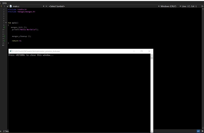

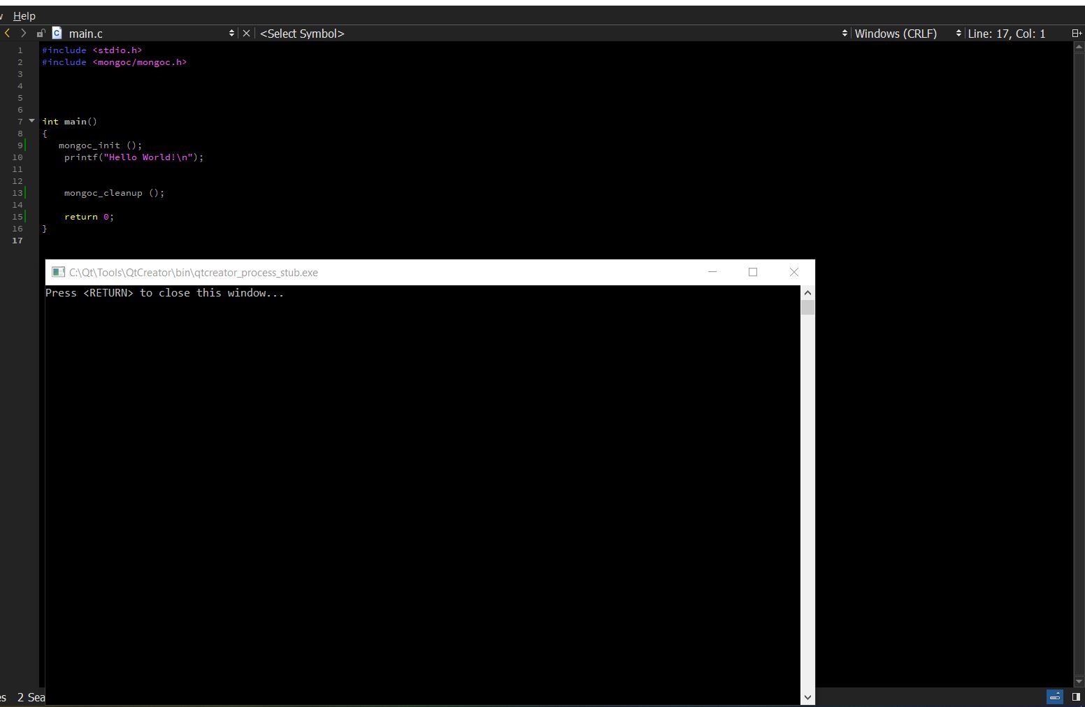

I made a mistake in writing the post, I did it as you mentioned but I still don’t have the solution to the problem. I leave a simple code that I have done, as you will see, it doesn’t response.

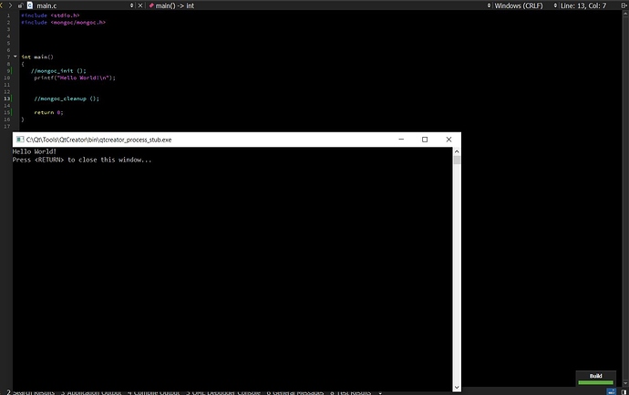

So, when i commented the mongo commands, its response successfully

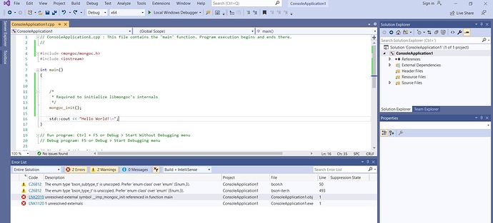

.Tested with VIsual Studio, the same history.
@Cesar_Cherre Sorry for the delayed reply. I somehow missed the notification of your response. Are the unresolved external symbol errors the result of Visual Studio not being able to locate the libraries? When you build the console application, do you see any warnings from the compiler?
