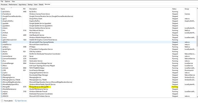

hello, please go to task manager, then service and make sure mongodb is running
if not, run it ,they try your campus or shell for connection.it worked for me!
