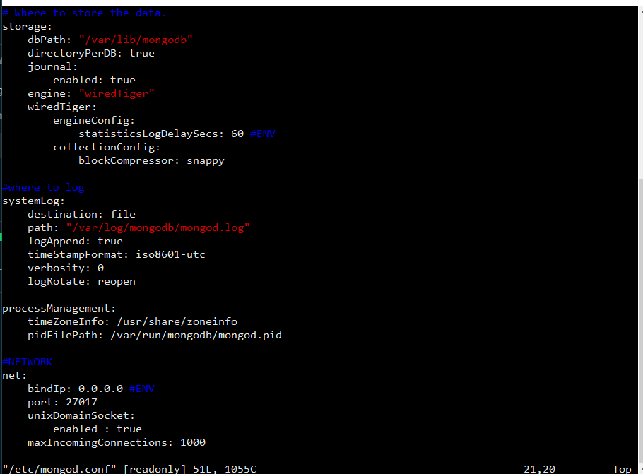

Thank you, can you also post your config file of the mongod you are trying to start.

Here is mongo config:

the “log file” set in the config should be showing what errors are encountered when mongod tries to start. if it gets an error, it will just exit to keep data safe meaning there won’t be a service listening on port 27017. this also makes it easy to search the log file because the error won’t be far away from the last line logged.
Thank you and That make sense, but i keep seeing oplog command over and over. current log file size is actually 3GB due to that over and over logging {verbose:0}.

1M does not seem big but before tinkering with the data, let’s try cleaning log files first to check if it heals.
if you think the current log file might be needed for older events, stop the server first, move it to a safe location, then restart the server. if not, just edit the config file so it reads "logRotate: rename" and try restarting the server.
Got you did same and still seeing same issue, service is started but mongo shutdown itself.
