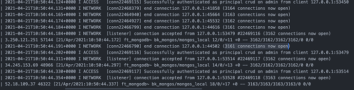

I have a problem regarding to the Mongo client connections. I want to understand why is mongo opening new connections for the same client, the same query. I’m currently using PHP 5.6 with Mongo 3.6.17 and the mongo php driver is GitHub - mongodb/mongo-php-driver-legacy: Legacy MongoDB PHP driver.

Note: Every time reloads the page that uses the MongoClient is opening a new connection, which is not what I want. I’d like to keep the same connection or when the user leaves the page Mongo can close that. Otherwise, I’ll end up with twice the number of connections from a single client. The following image demonstrates that 3161 connections opened, but having around 1000 users in the application doesn’t make sense for me.

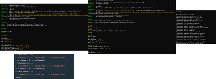

The code you’ve posted uses the MongoClient class from the legacy driver as you’ve indicated. As I mentioned, there is a new extension (ext-mongodb) along with a new library (mongodb/mongodb on packagist), which is what we support. The legacy extension is no longer supported. Please run the following commands in your project directory one by one and post the complete output so we can figure out what you’re running:
composer show mongodb/mongodb
composer show alcaeus/mongo-php-adapter
php --ri mongo
php --ri mongodb
As you can see in that image that every time I do a find with the exact same params in the constructor, meaning the query is the same but mongo allow a new connection instead of reusing. (Doesn’t persist in my case) and for that I still see a lot of connections.
I’m using this (new MongoDB\Client)->test->zips; instead of MongoClient.
Thanks @Andreas_Braun
