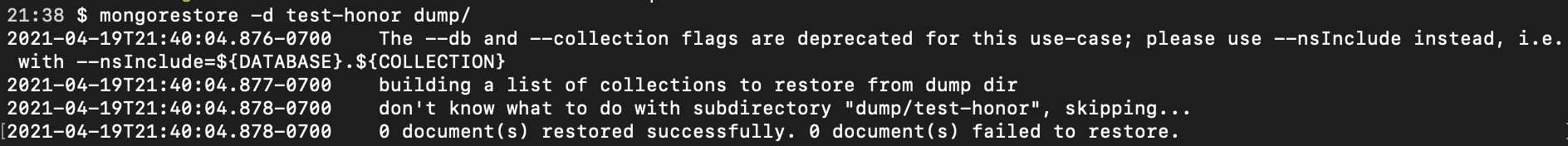

Thanks so much for the reply! I was working with a teammate and we simplified the commands a bit to use the default dump/ folder since we saw that the -d flag was deprecated our use of mongorestore as shown below.
Now we have the following dump and restore commands:
mongodump -d test-db
mongorestore dump/
It turns out the error was in how we were setting up our test database, a difference in environment variables! Thank you for the fast response anyways, it’s much appreciated :smile:
