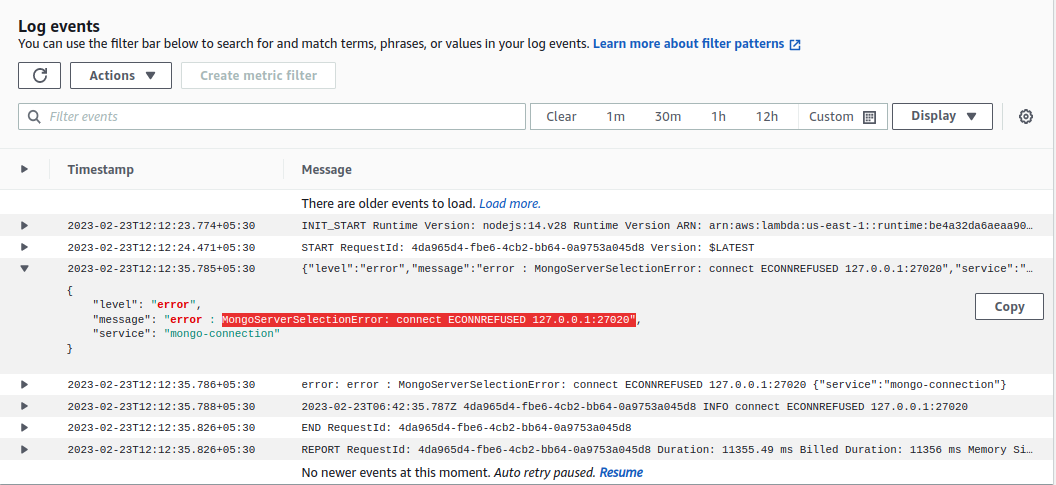

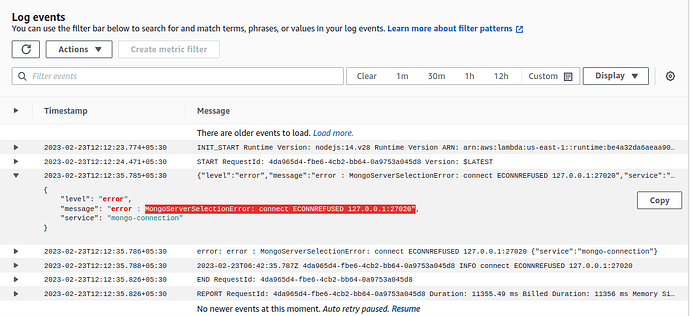

I am trying to create a mongo connection with auto encryption enabled inside the AWS-lambda function. I have also given the mongocryptd spawn path, but the connection failed with the following error
Is there any error in my code? for locally it’s working fine
