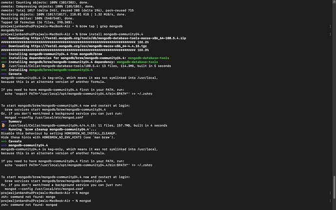

Hi @Prajwal_Janbandhu and welcome to the MongoDB community.
This portion of your screenshot looks to provide some answers:
Did you update your $PATH variable as recommended? If you did, do you see the path mentioned?
MongoDB 6.0 was recently released. Is there a reason you’re using MongoDB 4.4? While 4.4 will be supported for about 6 more months, would it make sense for you to upgrade to a newer version of the database to get the most recent security updates and features?

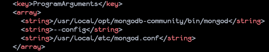

If you run brew services it should show the path to the plist file that brew uses to run the service. For my machine this points to ~/Library/LaunchAgents/homebrew.mxcl.mongodb-community.plist. This file will contain, among other things, the program arguments which controls how brew would start things up:
I see that I made a typo and the config file is mongod.conf and not mongodb.conf. Sorry about that.
