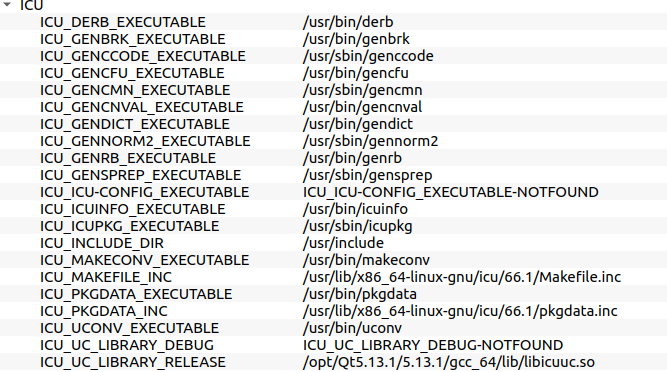

/usr/bin/ld: libmongoc-1.0.so.0.0.0: undefined reference to `u_strFromUTF8_66'
/usr/bin/ld: libmongoc-1.0.so.0.0.0: undefined reference to `usprep_close_66'
/usr/bin/ld: libmongoc-1.0.so.0.0.0: undefined reference to `u_strToUTF8_66'
/usr/bin/ld: libmongoc-1.0.so.0.0.0: undefined reference to `usprep_prepare_66'
/usr/bin/ld: libmongoc-1.0.so.0.0.0: undefined reference to `usprep_openByType_66'
clang: error: linker command failed with exit code 1 (use -v to see invocation)
make[2]: *** [src/libmongoc/CMakeFiles/bulk6.dir/build.make:93: src/libmongoc/bulk6] Error 1
make[1]: *** [CMakeFiles/Makefile2:988: src/libmongoc/CMakeFiles/bulk6.dir/all] Error 2
make: *** [Makefile:152: all] Error 2
@Puvvada_Venkata_Veera_Lokeshkumar Could you please provide the complete output, rather than just the last part? Also, could execute again from the start and this time add -DCMAKE_VERBOSE_MAKEFILE=ON
to the CMake command line? That will provide the actual build commands in the output and will make it easier to identify the source of the linker failure.

@Puvvada_Venkata_Veera_Lokeshkumar the output of the initial CMake command would have also been helpful. However, this last bit provides a clue:
Puvvada_Venkata_Veera_Lokeshkumar:
/usr/bin/cc -O2 -g -DNDEBUG -rdynamic CMakeFiles/bulk6.dir/examples/bulk/bulk6.c.o -o bulk6 -Wl,-rpath,/home/adminspin/build/mongoc_1.17/src/libmongoc:/home/adminspin/build/mongoc_1.17/src/libbson:/usr/local/lib:/opt/Qt5.13.1/5.13.1/gcc_64/lib libmongoc-1.0.so.0.0.0 -lsasl2 -lssl -lcrypto -lrt -lresolv -lsnappy -lz /usr/local/lib/libzstd.so /opt/Qt5.13.1/5.13.1/gcc_64/lib/libicuuc.so …/libbson/libbson-1.0.so.0.0.0 -pthread
The linker error that is produced just after is /usr/bin/ld: libmongoc-1.0.so.0.0.0: undefined reference to u_strFromUTF8_66
. It seems that the linker is being fed the completed path to libicu as /opt/Qt5.13.1/5.13.1/gcc_64/lib/libicuuc.so
. I would recommend checking the output of the CMake generation command to see what path it reports as the location for ICU. You might have another ICU on your system (of a different version) being found in one step and then a different being used here.
It seems that you have ICU components under /usr/
and also under /opt/Qt5.13.1
, which indicates two different installations of ICU. I would recommend that you have a look at the CMake documentation and pass additional options so that it finds all the ICU components from a single ICU installation. I do not use Qt, so I am not sure whether you are better served by using the ICU under /usr
or the one from Qt.
