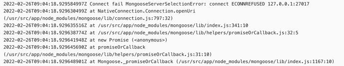

this is log on server

Connect fail MongooseServerSelectionError: connect ECONNREFUSED 127.0.0.1:27017
at NativeConnection.Connection.openUri (/Users/ductrung/Documents/ec2Decord/node_modules/mongoose/lib/connection.js:797:32)
at /Users/ductrung/Documents/ec2Decord/node_modules/mongoose/lib/index.js:341:10
at /Users/ductrung/Documents/ec2Decord/node_modules/mongoose/lib/helpers/promiseOrCallback.js:32:5
at new Promise (<anonymous>)
at promiseOrCallback (/Users/ductrung/Documents/ec2Decord/node_modules/mongoose/lib/helpers/promiseOrCallback.js:31:10)
at Mongoose._promiseOrCallback (/Users/ductrung/Documents/ec2Decord/node_modules/mongoose/lib/index.js:1167:10)
at Mongoose.connect (/Users/ductrung/Documents/ec2Decord/node_modules/mongoose/lib/index.js:340:20)
at Object.<anonymous> (/Users/ductrung/Documents/ec2Decord/app.js:19:10)
at Module._compile (node:internal/modules/cjs/loader:1102:14)
at Object.Module._extensions..js (node:internal/modules/cjs/loader:1131:10) {
reason: TopologyDescription {
type: 'Unknown',
servers: Map(1) { '127.0.0.1:27017' => [ServerDescription] },
stale: false,
compatible: true,
heartbeatFrequencyMS: 10000,
localThresholdMS: 15,
logicalSessionTimeoutMinutes: undefined

The error ECONNREFUSED means no mongod is listening at the given address on the given port.
From your screenshot we can see that you have a mongod running on your system. We need to see the parameters used to start it.
Share the configuration file
Share the output of the commands
ss -tlnp
ps -aef | grep [m]ongod
If ss does not exists on you system, try netstat with the same parameters.
