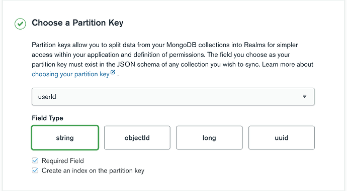

Wow, great development! I was waiting for a wrapper like this. To test it out it created a new Expo project based on the javascript Expo template you provided (not the TypeScript). The todo app runs flawlessly but once I enable the sync then it throws me a partitionValue must be of type ā€˜string’, ā€˜number’, ā€˜objectId’, or ā€˜null’ error. I tried several things to resolve it especially using the example code you provided for Native React. I got stuck. Any ideas what I do wrong here?
Hi @Joost_Hazelzet, the partitionValue must be setup in Atlas.
If you want to enable Sync, you will need to set a partitionValue. This can be arbitrary, but it is usually an ID that the data can be filtered on (as in this example, the userID).
You can dynamically set the partitionValue in the RealmProvider component:
return (
    <RealmProvider sync={{user: loggedInUserObject, partitionValue: "someValue"}} ><TaskApp /></RealmProvider>
The value should mirror the same type that you have setup in Atlas.
Glad you are enjoying the library! Let us know if this helps :slight_smile:
Hey Andrew, yes it was the missing partitionValue in the RealmProvider and and now the Todo app is running like a charm including the tasks synched to the Atlas database. Thank you. :smiley:
My code is available as Github repository https://github.com/JoostHazelzet/expoRealm-js in case somebody wants to use it.
