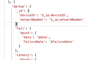

About 2, we need to check the language grammar we are using for playground. It’s possible that for some reason it only checks for valid JS but not for valid JSON. Could you share a screenshot of where you’d expect to see syntax errors?

Here is a little snip that should display an error:

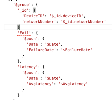

If I switch to JavaScript file association, the error is shown as a redline:

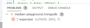

… and it’s also logged in the Problems display:
I would like to have this capability without having to change the file association for .mongodb files.
