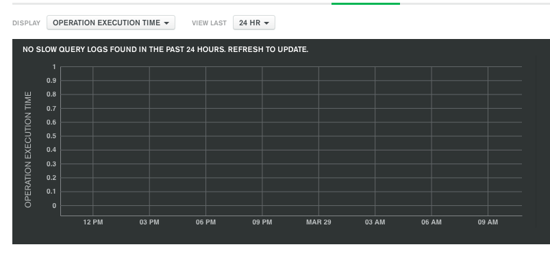

Note that when this issue originated, I have made no changes to my codebase - previously it was fine. I figured this was related to a slow DB query so I checked the profiler, but:
It seems like there are no slow queries, which I’m not so sure about. I’ve went and added a few additional indexes but it hasn’t really helped anything. I’m pretty much out of ideas - is there anything that could have caused this recently on the Atlas side? FWIW, my local DB/codebase operates fine, it’s just prod that’s breaking.
