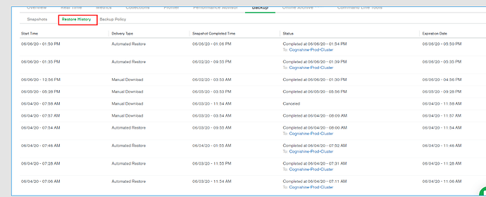

Whenever I restore a snapshort via mongo db atlas UI , this snapshorts moves from the “SnapShots” to the “Restore History” tan.
From this minue , there is no option to use this snapshort anymore as its gone from the UI and lost forever.
This is where I click the restore :
After a succusfull restore , I see the restore History , but there i sno way to restore using that snapshot again

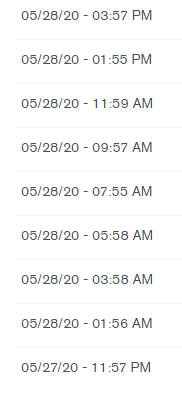

and look at a day where I did not restore.
I se a snapshot every 2 hours
The snapshots are NOT on the next pages.
After I restore them they were completly gone from the Snapshot tab

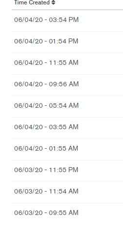

Please look on the attached file.
My policy is to backup every 2 hours , which is what I usually see :slight_smile: a snapshot is created every 2 hours exactly.
However , pay a close attemntion : see the difference between each snapshot (the timing)
