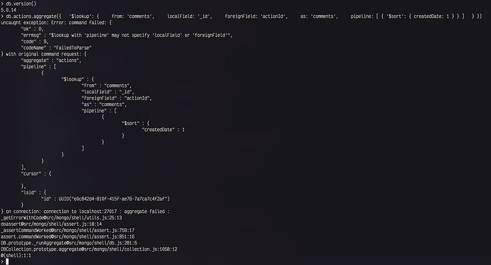

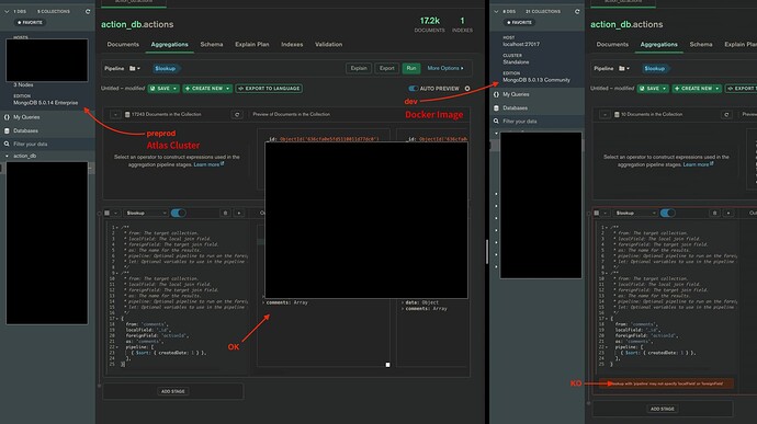

We were working with the aggregate pipeline ($lookup) and faced an issue ("$lookup with ‘pipeline’ may not specify ‘localField’ or ‘foreignField’") with the community version that does not happen in the Enterprise edition.
Can you guys tell me if it’s expected behavior?
Thanks !
  from: 'comments',
  localField: '_id',
  foreignField: 'actionId',
  as: 'comments',
  pipeline: [
    { $sort: { createdDate: 1 } },

  4. Yes, I first found it running outside of Compass

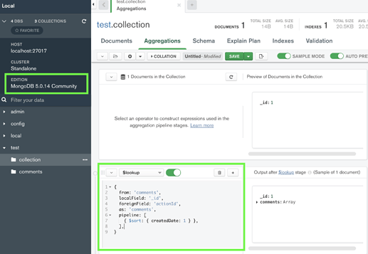

I have the pipeline below used in my tests:
  '$lookup': {
    from: 'comments',
    localField: '_id',
    as: 'comments',
    pipeline: [ { '$sort': { createdDate: 1 } } ]

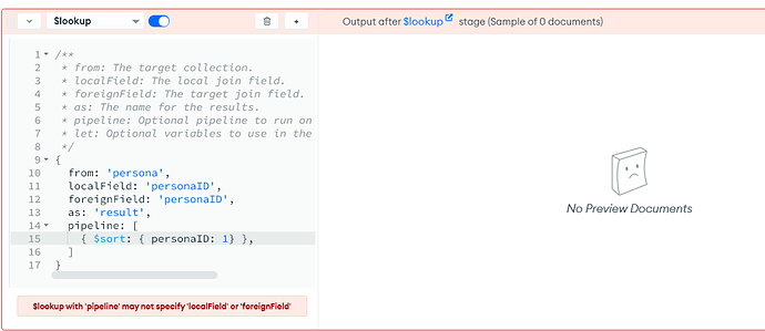

As an additional note, I tested the $lookup via Compass and managed to get the same error you have provided when I set the FCV to “4.4”.

  1. I am using Compass Version 1.33.1 (1.33.1)
  2. MacOS Monterey 12.4
  3. Unfortunately I cannot share document samples since they contain personal information
  4. it does
It was indeed related to the FCV 4.4! Thanks a lot!
Setting db.adminCommand( { setFeatureCompatibilityVersion: "5.0" } ) fixed the problem :slight_smile:
