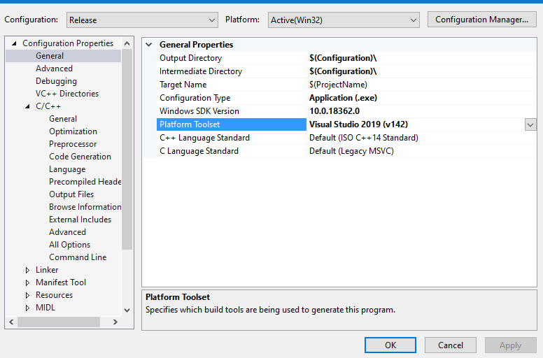

Project settings in VS2019

Can you please share the version of Visual Studio and compiler that you are using?
Its VS2019 and Win32 config.
