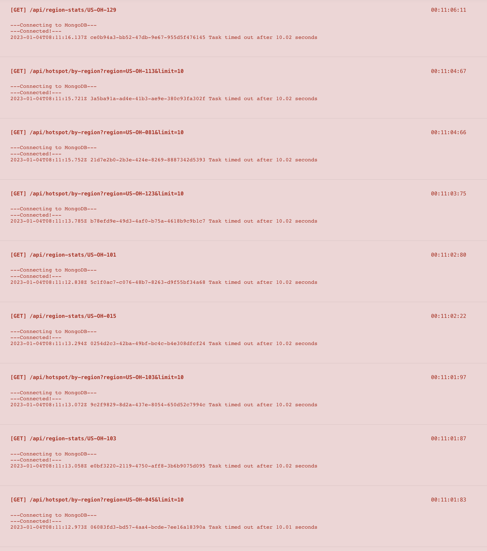

I’m still encountering this issue about every 2 days, usually early in the morning (Pacific time). It lasts for a minute or two. There’s a spike in connections and most of my queries are exceeding the 10s timeout on Vercel. It does seem like MongoDB successfully connects (see screenshot where I log the successful connection). The queries being run in these functions take < 200ms normally. Note that the Mongo connection is successfully cached when running normally. For some reason during these weird spikes, it tries to create a connection on each function request.

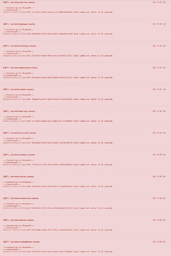

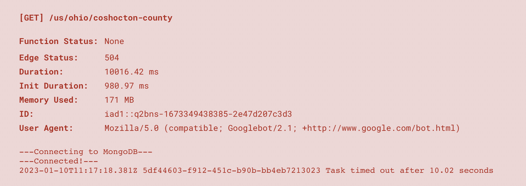

  • When I see a cluster of timeout errors, they’re usually a bunch of google bot requests all happening milliseconds apart. See attached screenshot. During that exact second there were 34 requests from google bot requests.
  • In the attached screenshot, you’ll notice the console.log output relating to the MongoDB connection code. When everything is functioning normally (outside of these error/connection surges), I notice the console.log messages appearing once and all further requests seem to use the existing, cached connection.
I’m wondering if the existing connection disconnects and google attempts to load 20 or 30 pages all at once. Since there’s no existing connection, I’m assuming it initiates a new connection for all 30 new requests. And there wouldn’t be time to cache the 1st request and share it with the remaining 29, because the requests all came in essentially at the same time. That’s just my speculation. Though that may explain the spike in connections, I don’t think it would explain why those 20-30 requests timeout.

Expanded detail view:
