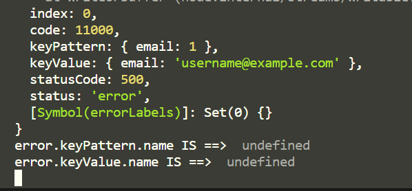

here is a screenshot of the error when trying with a duplicated email :

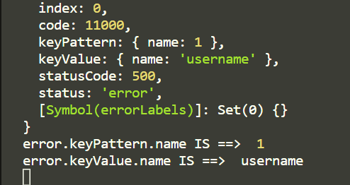

let me explain my problem again, first I entered a duplicated username which is in my case (username), here is the output of these theree lines :
  console.log("THE ERROR IS ==>",error);
  console.log("error.keyPattern.name IS ==> ",error.keyPattern.name);
  console.log("error.keyValue.name IS ==> ",error.keyValue.name);
1
when trying with a new username and duplicated email both of
are undefined

It looks like the shape of the error object changes depending on the error.
When you have a duplicate username you get this:
keyValue: { email: 'username@example.com' }
and with a username you get:
keyValue: { username: 'john' }
The key provided within the keyValue section has the field name and field value, so you cannot have a generic lookup, you need to check what the key is and look at that.
