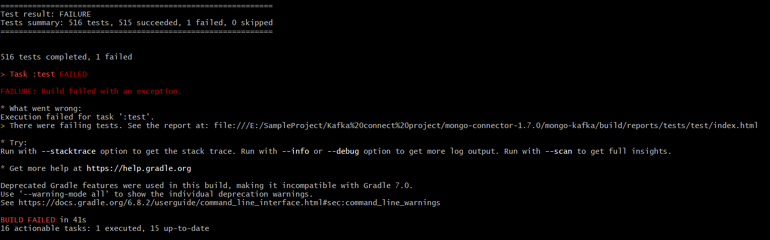

Hi @Ross_Lawley
I am not able to build the PR, It has some test case failure issue, Can you please check and let me know.
Also please let me know when you are targeting this release?
Hi @BRIJ_MOHAN_GUPTA,
I don’t think a PR has been created for this feature yet. Its not planned for this quarter.
Regarding the test failure, you’d have to look at the test report to understand more about what failed and why.
