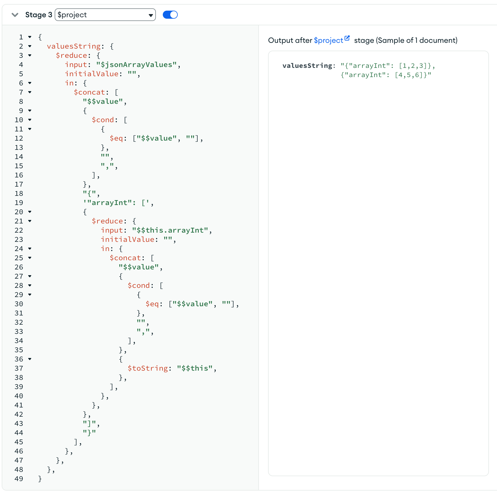

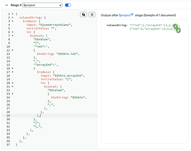

What we have done so far is to use a combination of $reduce along with $concat and $toString to “manually” do a JSON.stringify and have gotten quite far. The problem we are running into with this approach is we end up with trailing commas in the string. I tried to use $cond to check if we are in the last item in the array but $reduce does not seem to give us an iteration index we can use to determine if we are in the last item or not. Our test data looks as follows:

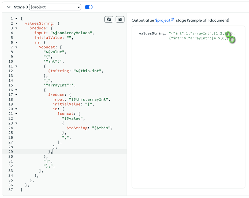

The real problem with this approach is the trailing commas within the objects themselves. We are building up the pipeline itself programmatically and it will support multiple types of documents so the complexity goes up quickly if we try to $substr all the instances where a trailing comma would be.
Our $project step looks as follows:

For anyone else experiencing a similar issue we have a work-around using $cond as follows to fix the trailing commas:
