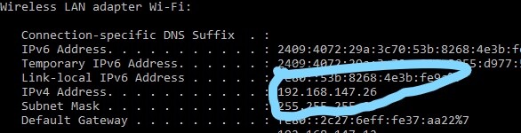

by default my mongodb instance listens to localhost, I tried to bind it with my ip address.
so i used ipconfig command to know my ip adress.
And then i used that ip address to bind in the config file.
And then i tried to connect the mongo shell from my same computer and everything worked fine.

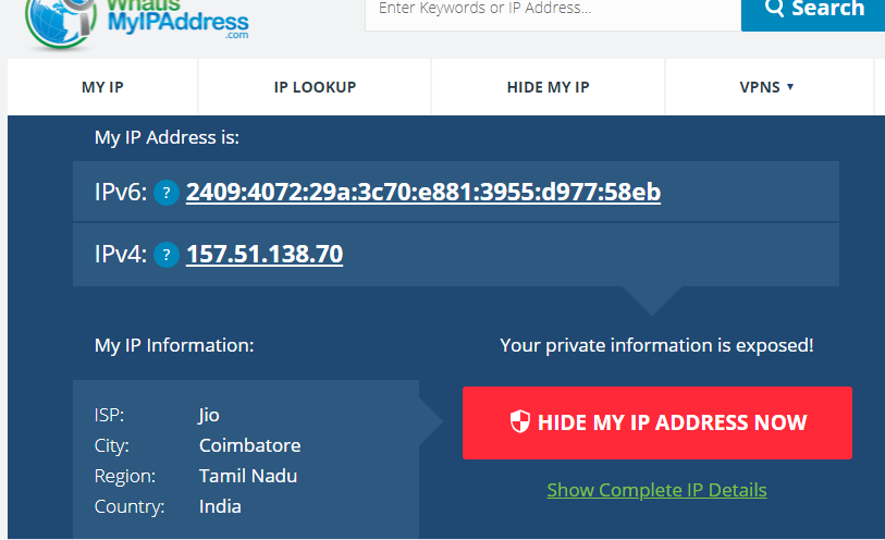

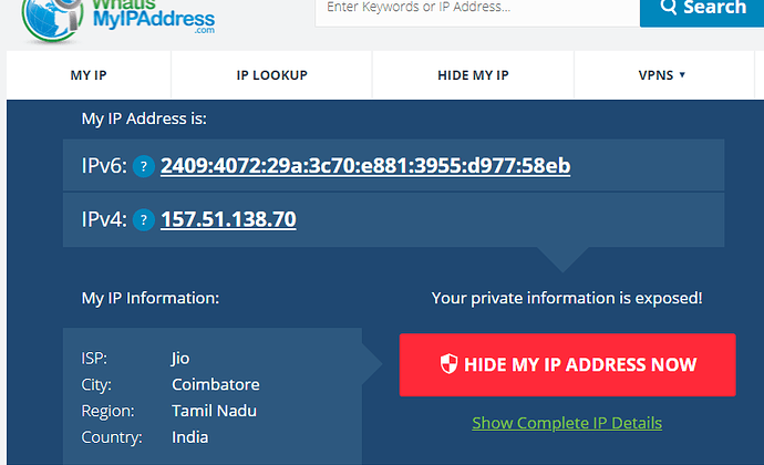

By surfring through the internet i read in some article where we need to bind our instance the public ip address in order to access it rometly from a different lan .
so i got my public ip address in whatismyipaddress.com
And i tried to use this ip address in the config file
Now i tried to start the mongod server with this config file and it stopped
so i tried to look into the log files and got the error as the requested address is not vaild in its context.
Kindly help me to know what is the mistake im doing!!

the ip address which i’ll get when i run ipconfig will be my private ip address right??..

Private ip address issue :
If i just use my private ip address which is shown in ipconfig , Then the mongod server starts and only i can able to access it …when i try to access it from my friend’s computer i’m getting this error of “Socket operation timed out”.
Hi @Shrikar_Man,
Here, 192.168.* addresses are Private IPs. You cannot directly connect to those over the public internet.
So, you will need VPN or something for port forwarding.
Explanation: Devices on the same side of the router as the private IP can talk to each other via the 192 addresses but outbound requests to public IPs from devices on the private network transit via the router and will originate from the router’s public IP, like this:
192.168.x.y (private IP) → router → 151.x.y.z (public IP)
So, you have to tunnel your incoming requests of the public IP to the private IP i.e., your friend’s computer IP via VPN, SSH, or port forwarding. Then you can connect.
