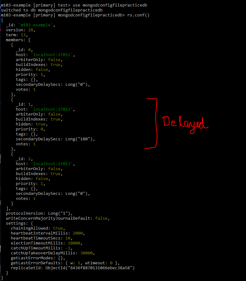

Hi, I am trying to setup a Replica set with 1 Secondary to have some delay from Primary.
Even though rs.config() shows correct desired configurations, there is no delay when I make changes in Primary. The Delayed one is instantly reflecting changes. Not sure why configurations look fine but there is no delay.
It will be really helpful if someone can give some suggestions to fix this or experienced something similar.
Or if you know some guide other below doc that can help.
I followed below steps to make it delay by following these docs: https://www.mongodb.com/docs/manual/tutorial/configure-a-delayed-replica-set-member/#example
cfg = rs.conf()
cfg.members[1].priority = 0
cfg.members[1].hidden = true
cfg.members[1].secondaryDelaySecs = 180
rs.reconfig(cfg)
Also attaching screenshot of rs.conf() for reference.
Hi @Naman_Saxena1,
The configuration is correct!
Do you read the data from the hidden node?
You should do it in 3 minutes.
Regards
Hi @Fabio_Ramohitaj ,
so after inserting a new document in Primary, I instantly opened Secondary Delayed node in MongoDb Compass and it was showing latest document. I basically wanted to test if delay is working properly.
My understanding was MongoDb Compass will NOT show newly inserted document before 3 mins or am I missing some information?
