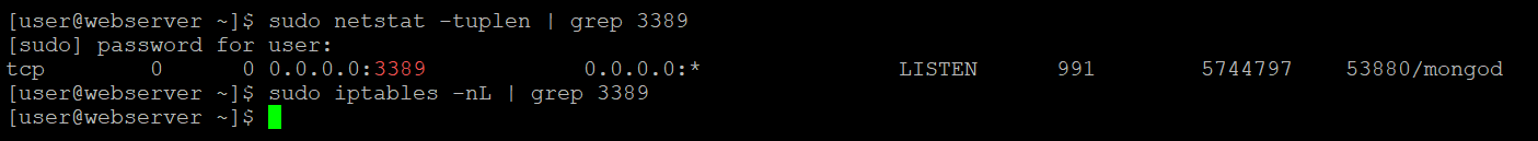

is that what you mean? if I am not mistaken, the port should be listening
