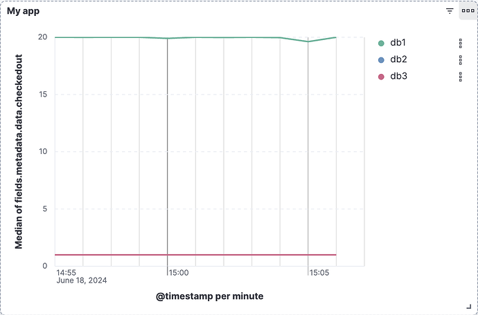

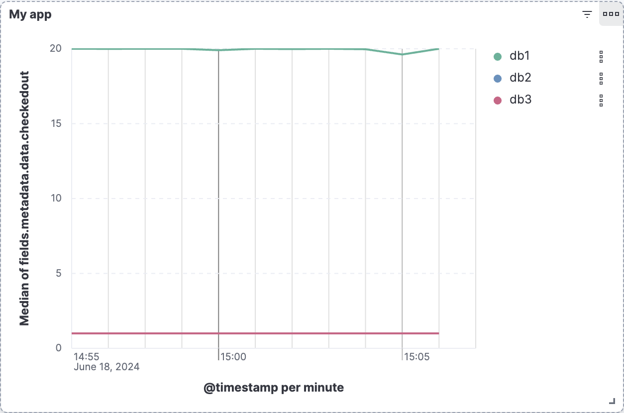

I have now more data about my connection pools on my different apps. I have maybe one question about it.
I have this application that performs a lot of finds, inserts, updates and deletes on db1 and it performs finds only on db2 and db3.
According to this graph, we can see that db1 has a median of 20 connections opened constantly (out of 20) while db2 and db3 has a median of 1 connection opened (out of 20).
With the informations I gave here, could it be considered as correct?
Thanks.
The connection pool is associated with the MongoClient instance; not a particular database, so it would be difficult to judge accuracy without more information ![]()
It would really depend on how you’re capturing/recording telemetry …
Yes sorry I forgot to add that each MongoClient is connected to one specific database (the uri would be mongodb+srv://username:password@host.com/db1).
Also, I only log when a connection is checking out like:
// this.conn is a mongoose connection
// this.conn.getClient() returns the mongodbclient instance
// this.checkedout is initialised at 0 in my constructor
this.conn.getClient().on('connectionCheckedIn', () => {
this.checkedout -= 1;
this.conn.getClient().on('connectionCheckedOut', (e) => {
this.checkedout += 1;
// logs only the used connections
this.logger.info(`MongoDB[${this.name}] Connection is checked out.`, MONGO_INFOS.MONGODB_CHECKED_OUT, { checkedout: this.checkedout });
