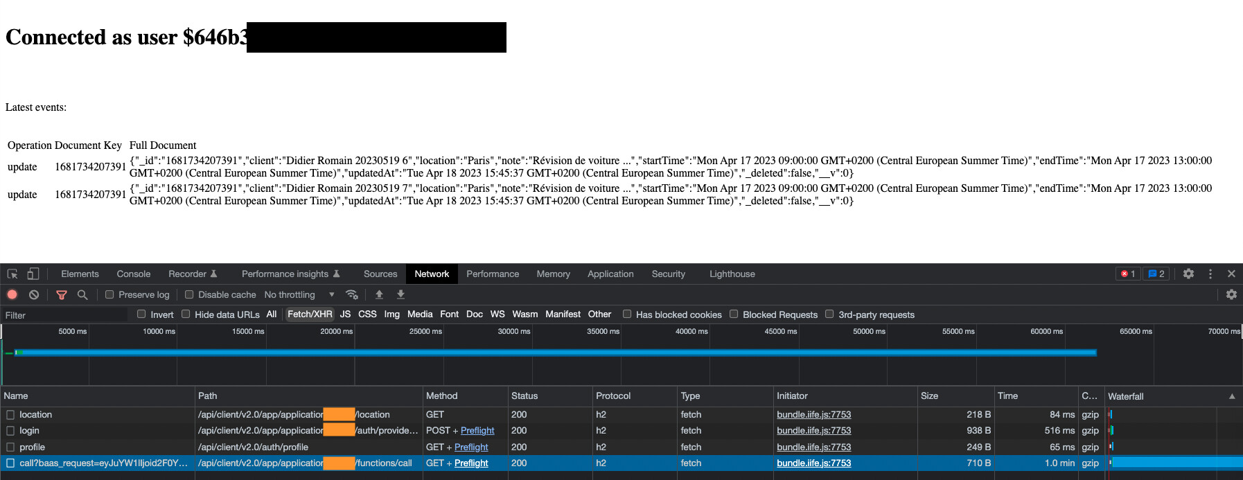

I am looking for the same thing as you. Here is the summary of what I have found so far (I am splitting my message into several posts because I am limited to 3 links and 1 attachment per message).
  • WebSockets is not the only solution to stream events to the browser. You also can use Server-sent events. Basically, it is an HTTP connection between the browser and the server being kept open to stream events.
  • The web SDK of Realm (which is provided by MongoDB) is using the Server-sent_events throughout the BAAS of MongoDB Atlas (Backend As A Service). See the tutorial here.
  • This MongoDB tutorial explains how to set up WebSocket by deploying your own backend code. Would it be possible to do it with BAAS? Would it be possible even without BAAS?
  • Would it be possible to stream using HTTP (Server-sent events) directly with the “Data API” / “HTTPS endpoints”?
