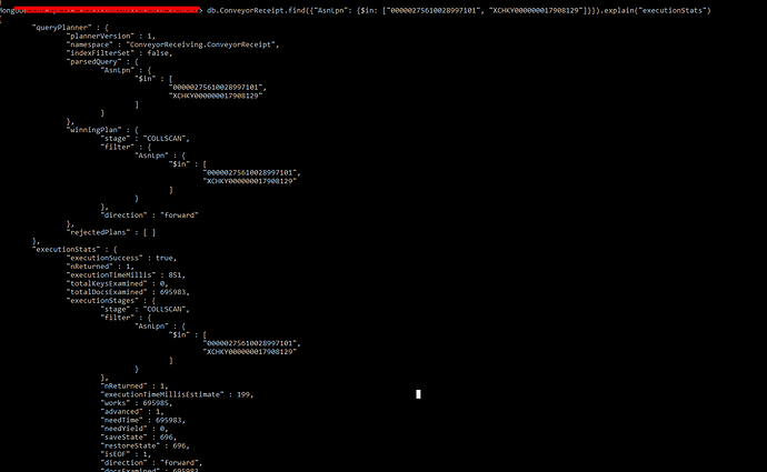

I have an index on the AsnLpn field but for some reason when I use an $IN statement it seems to bypass my index for a COLLSCAN

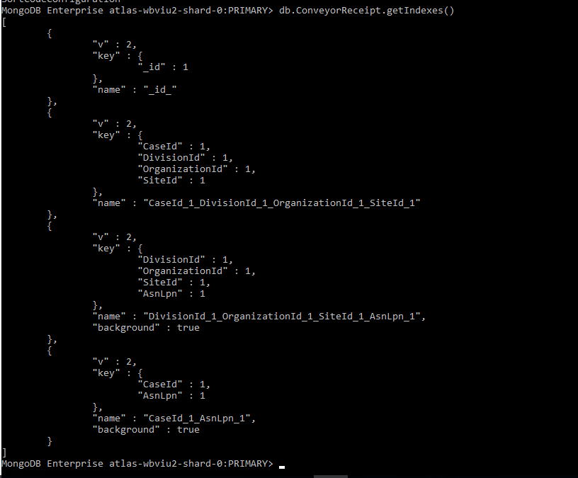

Please provide the output of:
db.ConveyorReceipt.getIndexes()

Thanks Steeve, I actually posted the wrong query. Here’s the correct query, showing its not using index

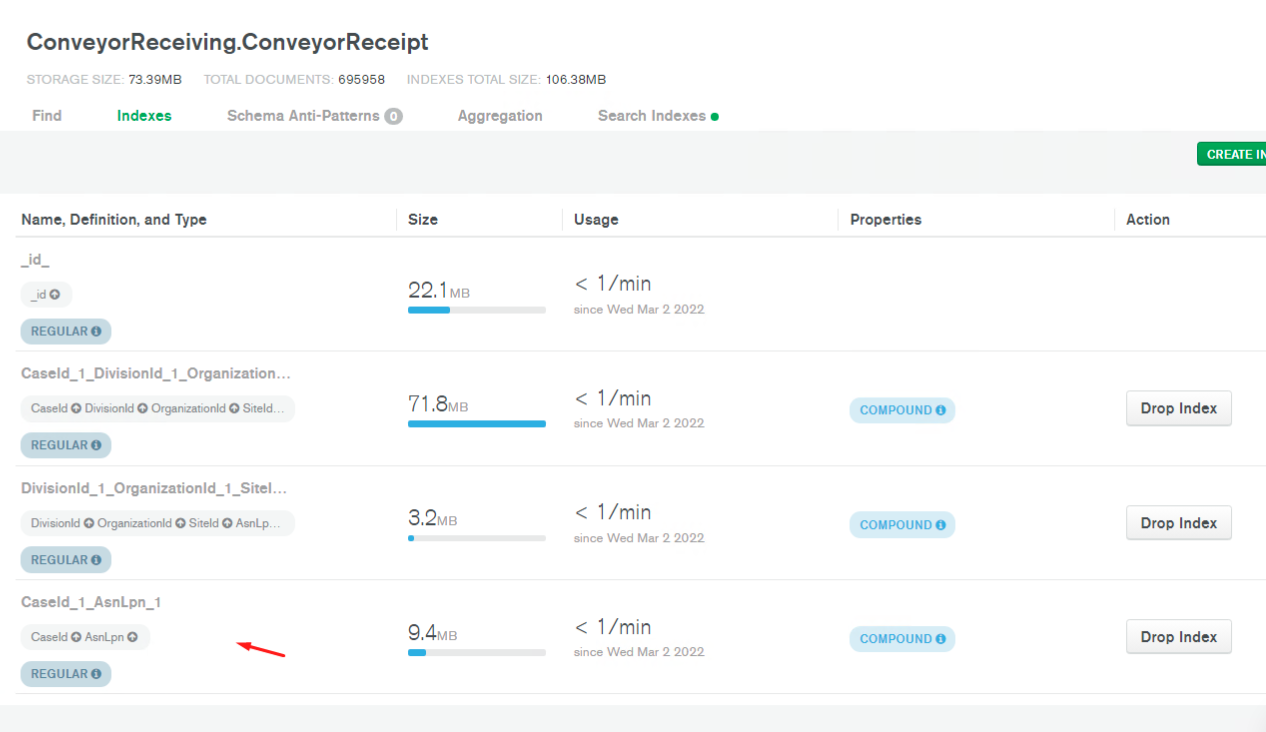

and here are the indexes

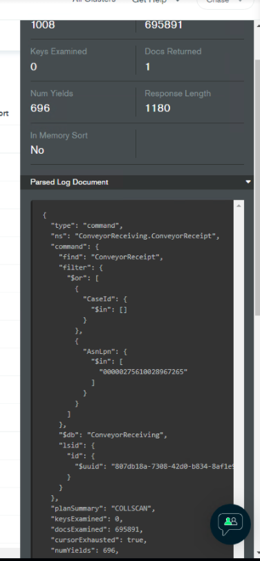

This is an $or query. That means all documents that match first condition, union with all documents that match the other condition. If you don’t have a separate index for each of the conditions it’ll need to do a collection scan anyway.
Thank you Asya, so id have to have individual indexes on each of those field CaseId and AsnLpn?
