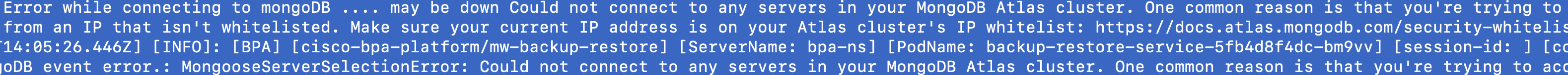

@Dan_Mckean we don’t see any suspicious things , we are only seeing below error in the log
Error while connecting to mongoDB
may
be down Could not connect to any servers in your MongoDB Atlas cluster.
One common reason is that you’re trying
to
from an IP that isn’t whitelisted. Make sure vour current IP address is on vour Atlas cluster’s IP whitelist: httos://docs.atlas.monaodb.com/securitv-whiteli
14:05:26.446Z] [INFO]: [BPA] [cisco-bpa-platform/mw-backup-restorel [ServerName: bpa-ns] [PodName: backup-restore-service-5fb4d8f4dc-bm9vv] [session-id: 1 [c
10DB event error.: MonaooseserverselectionError: Could not connect to anv servers in vour MonaoDB Atlas cluster. One common reason

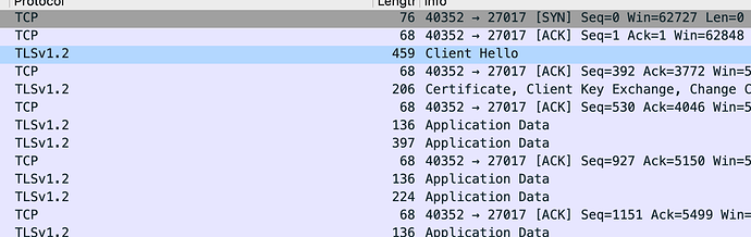

Since this issue is reproducible all over the time, we tried packet capture between working pod and non working pod [both of same deployment version], the observation here is in the non working scenario, after the client makes TCP connection it tries to perform TLS client hello but the pod is not getting reply from the mongodb server resulting in timeout and repeated retries. In all retries the TLS client hello is sent but mongodb server is not replying back.
We further did a deep dive analysis on the packet capture and found that, when the client is making “Client Hello”, for working pods its taking TLSv1.2 protocol and in a non working its using TLSv1 protocol layer
It is very intermediate, application fails to get connection with TLS1.0 , but with TLS1.2 is able to connect successfully

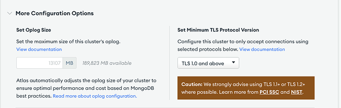

In mongo db atlas we have set TLS 1.0 and above , still the pod crashes when at run time TLS1.0 gets used.

And did you enable it by editing the deployment configuration and changing it as follows?
But yes, in theory Atlas can still support TLS1.0 - if that’s been enabled in the cluster settings (as above) but it’s not being accepted for those incoming connections I’d suggest opening a support case (top right in Atlas) and see if our support folks can help take a look at things from the Atlas end of things.
@Dan_Mckean
yes we have enabled deployment configuration from day 1 here is screen shot for the same
In that scenario it should work right with TLS1.0, and from the application we are not setting TLS version, could be mongoose driver [5.8.7] thats using it at runtime. Is there a way we could set TLS version when we try to connect via mongoose?
Below is the TCP dump for working pod
Below is the TCP dump for non working pod
