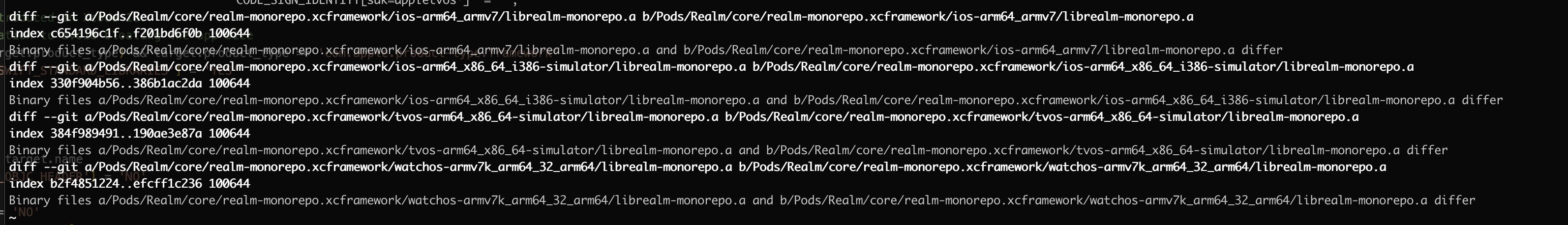

I did a git diff against two branches where the upgrades were done on separate machines, and I see this:
This seems to be telling me that the binaries are different. I’m curious why this is happening and/or if I’m misinterpreting what’s happening. Are the binaries actually different? Why? And if so, what is CocoaPods doing differently in the bundle exec pod install when it’s done on an Intel vs M1 mac?

Yes, the compiled binaries are different - are you attempting to build for the same iPhone on both the Intel as M1 Macs? Do they both have the current version of cocoapods installed? 1.11.3 at the moment.
I can confirm the same Cocoapods version was used , 1.11.3, but I think I was targeting a different simulator. On the Intel mac it was an iPhone 13 Pro on iOS 16 I believe, and the on the M1 it was an iPhone 12 running iOS 15.2.
Could you help me understand why those compiled binaries are different? The Realm library ships with those compiled binaries, so I was curious how those differences come to be? I guess I might be operating on the wrong assumption that what you get from a pod install doesn’t depend on the architecture of your system/what iPhone you’re building to - but just the version of the library you’re installing?
