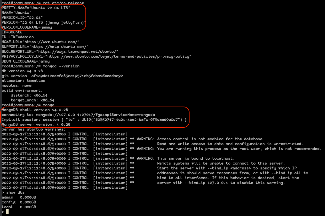

I understand that it is end of life, but I was curious to know if it is even technically possible to have a MongoDB 4.0 instance running on Ubuntu Jammy?
Regards
Ani
Is it possible to run MongoDB 4.0 on Ubuntu 22.04? Yeah, pretty much anything is possible if you’re determined.
Is it recommended? Nope.
I just downloaded the generic Linux tarball, expanded it and ran it. This means that it’s not installed as you would expect when installing a .deb package and therefor I have to manually start and stop the process. I also have to create the users and data/log folders and make sure everything else is properly set up. Being that this is not an Ubuntu specific version, there might be performance issues. Also note that by running the older version, I’m missing out on all of the new features, performance improvements, security updates, etc of the new versions.
Now having said that, you were probably asking if one is able to apt install ... version 4.0. Given enough time I might even be able to install outdated packages to make the 4.0 version install that way, but why would I want to spend time on basically breaking my system, when I could be doing something fun and productive?

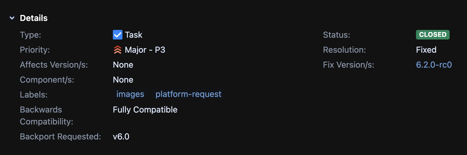

Looking at the JIRA ticket mentioned a couple of times earlier in the thread we see the following:
Only v6.0 is listed in the Backport Requested section.
I don’t know how much work it would take to get 5.0.x packages, but based on past history I would like to think that they would be able to get this version working on 22.04 as well, especially since 5.0 will be supported until October of 2024. This means the next LTS version of Ubuntu (24.04) will be out before support on the 5.0.x line ends. There is even hope that 4.4 will be supported on Ubuntu 22.04.

As @Doug_Duncan noted, SERVER-62300 (Add support for Ubuntu 22.04 x86) has recently been committed to the current development branch (6.2.0-rc0). SERVER-62301(Add support for Ubuntu 22.04 ARM) is currently in code review.
These changes are scheduled to be backported to the 6.0 production release infrastructure.
