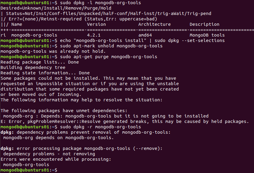

Please, if you have the procedure to do this, i will be greatful. Look my try do remove packge mongo-org-tools by my MongoDB 4.2.1 server:
Thanks,
Henrique.

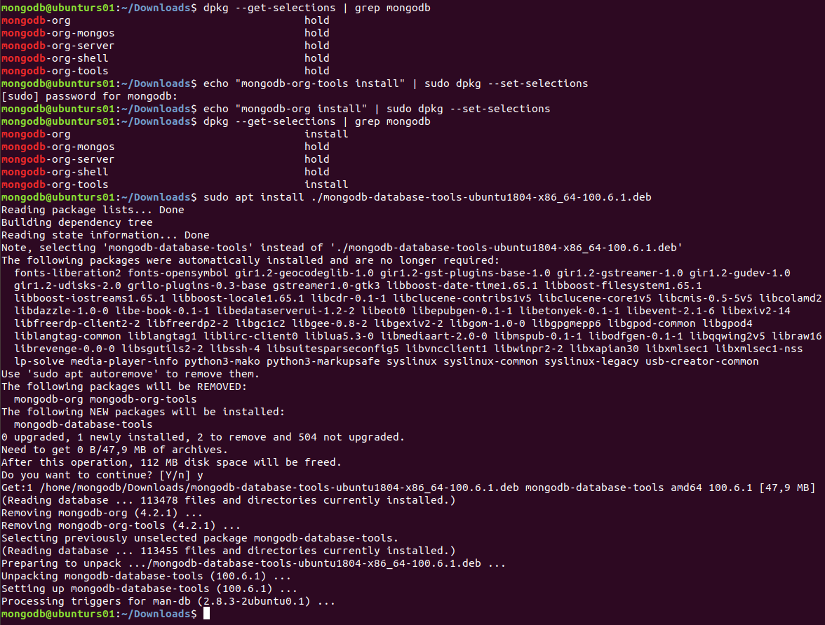

Thanks for all Chris!
I found the problem: Only remove the Hold, but not only mongodb-org-tools but too mongodb-org:
Thanks!
Henrique.
