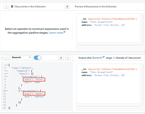

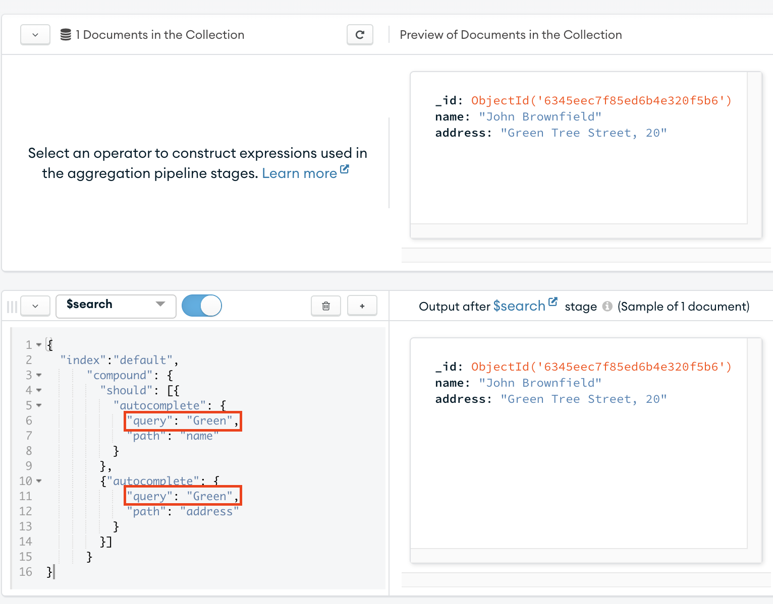

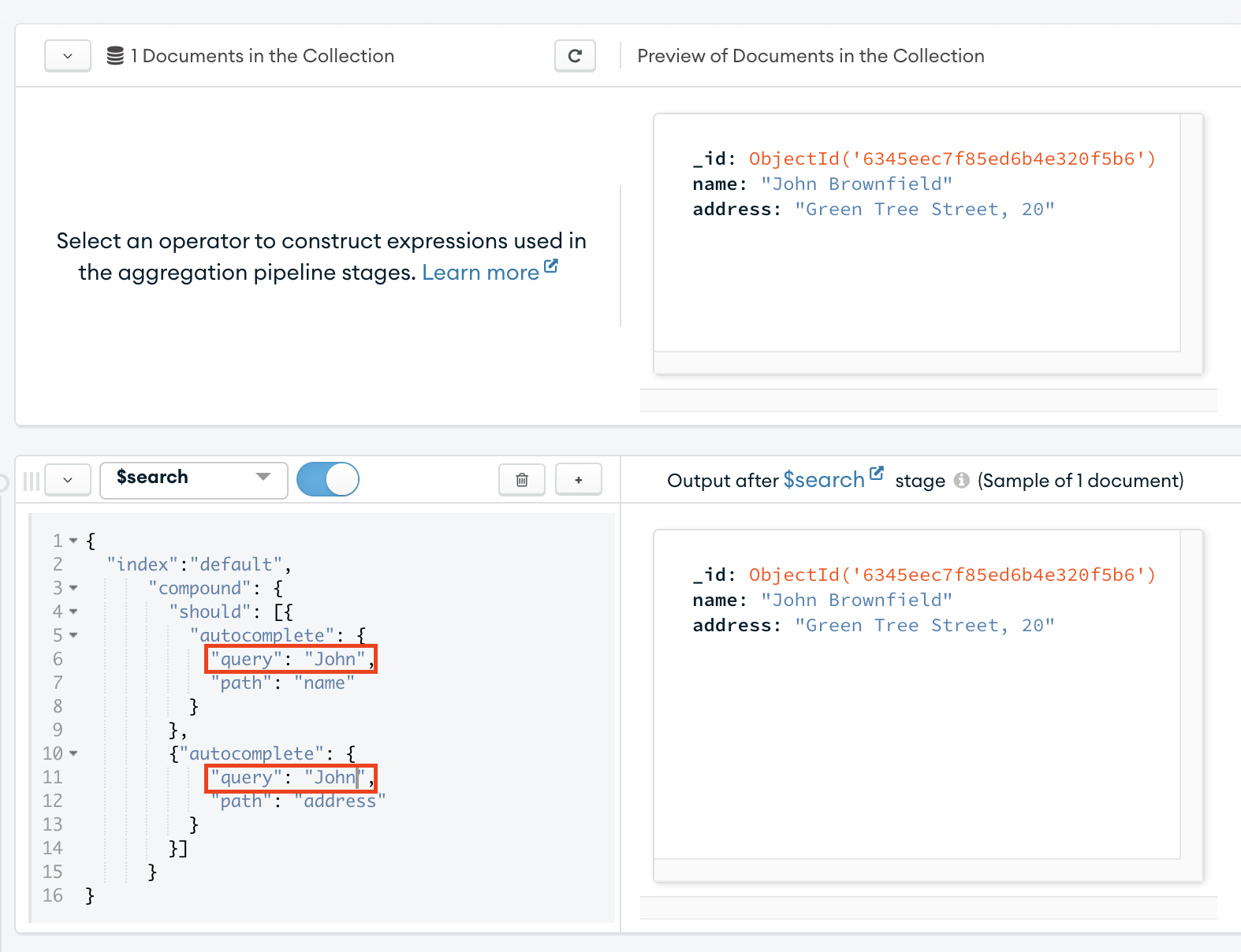

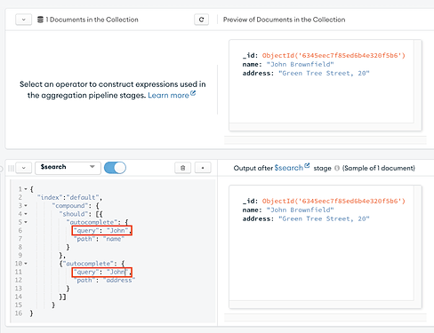

In saying so, have you tried compound with autocomplete to see if it meets your requirements? I did 2 simple tests based off your example:
The two tests were to try and retrieve the same document as you have mentioned.
Examples are from Data Explorer
If this is not what you’re exactly after, there is a feedback post regarding autocomplete usage on multiple fields (which sounds like it would suit your use case). It is currently being worked on at this stage.
