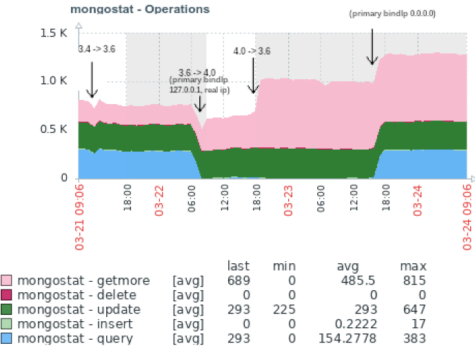

The only change - besides mongod upgrade - was adding readPreference-parameter to mongodb-connect string to our software components (readPreference=secondaryPreferred) on 3.6 → 4.0 upgrade and removing it (debugging our own software) on the last jump (bindIp 0.0.0.0), which explain the blue area changes.
We have a very simple monitoring for this cluster using Zabbix and mongostat. Today I noticed that, on the primary node getmore commands jumped during the upgrades. LogLevel 1 tells me that (currently, no idea about before) that, those are 99,9% to collection oplog.rs (local.oplog.rs). The graph below represents statistics of the primary node:
