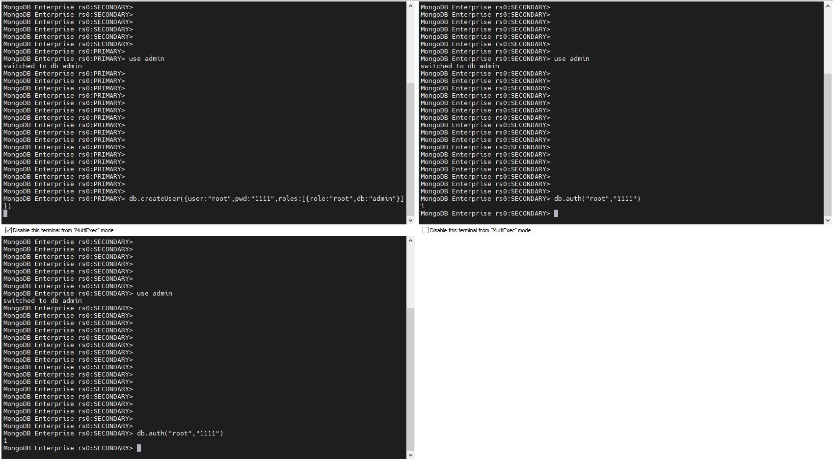

Hi, @Manu
I’ve recreated the situation.
If you look at the picture, I created a user in Primary. And the message of completion ({“ok”:1}) has not come out.
However, the user was able to log in from Secondarys.
I was asking a question about this.
ps. The log for [conn49] was not released this time, and the user creation of Primary was not completed until about 10 minutes later.
