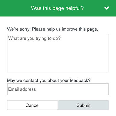

The bottom right of a documentation page should have a “Was this page helpful” feedback widget. If you click on Yes/No you can provide additional suggestions for improvement:
docs-helpful
Aggregate feedback information on helpfulness of pages is useful to highlight pages needing improvement to the documentation team.
