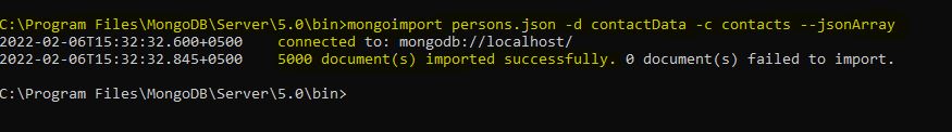

Step No. 6 ( Open the command prompt (run as a administrator) type (the addressing line. Example ( cd C:\Program Files\MongoDB\Server\5.0\bin** ) .
CD Command used for ( to Change the Directory ) Means that find that file in the given location.
Step No. 7 ( mongoimport persons.json -d contactData -c contacts --jsonArray ) In my case take as example (your may different).
-d (used for creating Database) and
-c (used for the creating the collection inside the database)
–jsonArray (used to import JSON files correctly to the database.
