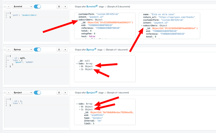

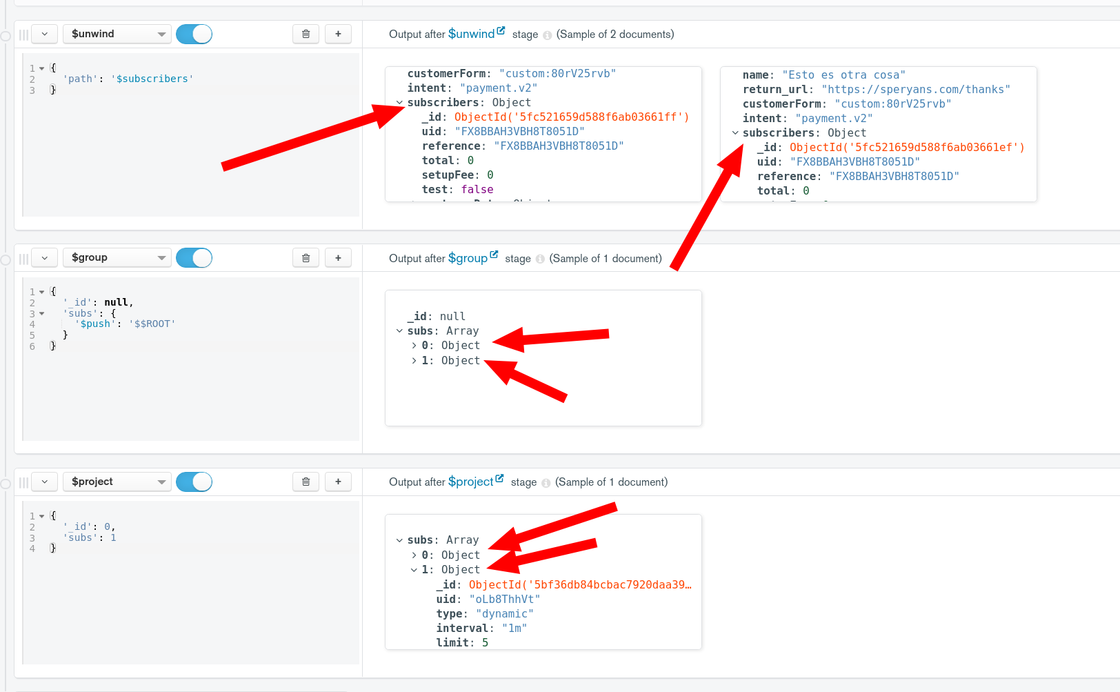

    '$match': {
      'entity': params.entity,
      'status': 'active'
    '$lookup': {
      'from': 'appsubscriptionssubscribers',
      'localField': '_id',
      'foreignField': 'subscription',
      'as': 'subscribers'
    '$match': {
      'subscribers.0': {
        '$exists': true
    '$skip': batch.skip
    '$limit': batch.size
    '$unwind': {
      'path': '$subscribers'
    '$group': {
      '_id': null,
      'subs': {
        '$push': '$$ROOT'
    '$project': {
      '_id': 0,
      'subs': 1
I hope it’s what you want.
FYI: As you provided extended JSON format, I had to use mongoimport to insert them in MDB.
Cheers,
Maxime.
I don´t know how to put value on ‘path’ in the Compass because I am making the aggregation in the subscribers collection which the actual name is “apaasubscriptionspplans” . When you said…

At the moment you are doing a $lookup from the subscriptions collection to the appsubscriptionssubscribers collection. Which results in an array of appsubscriptionssubscribers docs into the subscriptions collection.
You can do the opposite if you like. Or you can also “lookup” (=join) on the same collection if this is what you are after. Totally works.

My aggregation in mogosh was:
```db.appsubscriptionsplans.aggregate([{
              '$match': {
                'entity': ObjectId('577660654629781000df9552'),
                'status': 'active'
              '$lookup': {
                'as': 'subscribers'
              '$match': {
                'subscribers.0': {
                  '$exists': true
            //{ $skip : batch.skip },
            { $limit : 2 },
              '$project': {
                '_id': 0,
                'subscribers': 1
Try my version with this at the end.
This is the return in mogosh: { subs: [] }
Not possible because you had something a minute ago :smiley: !
You did something wrong.
Use the “import pipeline from text” option in Compass to import the entire pipeline I shared earlier.
Also I suggest you have a look to this free training that will be useful for sure :wink: !
yes, in Compass already at stage $group “subs” is an empty array
Fix the earlier stage then. You can also disable some temporarily.
The earlier stage is the $unwind you made…
$unwind breaks arrays into multiple docs. If you have nothing after that stage, it means the array subscribers is empty in all the docs you have at this stage.
So something’s wrong above that.
