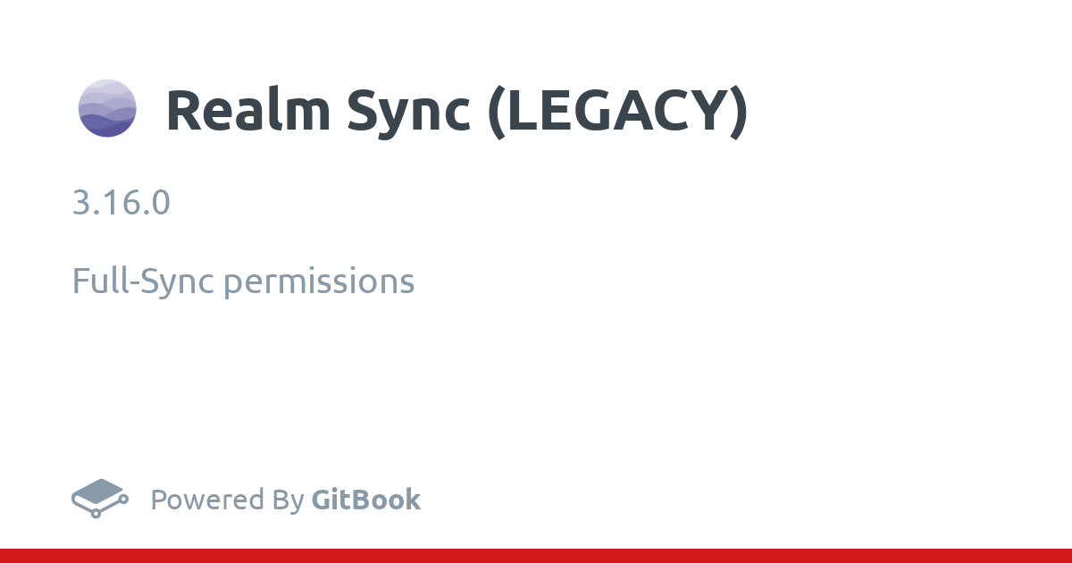

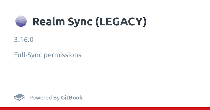

If you are trying to open another user’s realm then you need to grant permission to the user performing the open - see here:
Thank you for your explanation.
