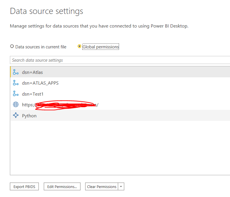

I don't receive all fields in Power BI from MongoDB Atlas using ODBC
It could be filters or other settings causing issue
What is the query you are using in editor
Check BI forums.You may get more help
