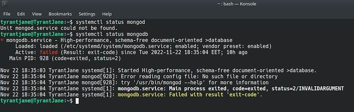

I can't start mongodb server, because it status=2/INVALIDARGUMENT

The error message is
Error reading config file: No such file or directory
