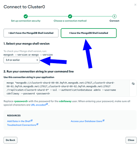

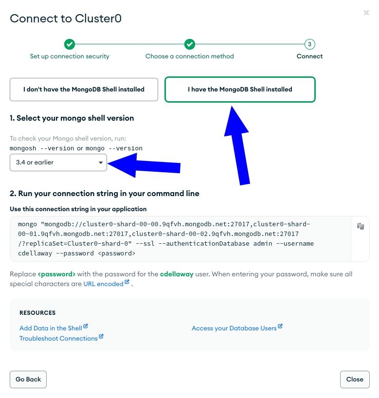

Looks like the DNS server you are using is not resolving the cluster.
If you select older versions in the ‘Connect’ dialog in Atlas you will get the legacy connection string which may work work better for you, or switch DNS servers.
Hello, thanks for your answer, but I don’t know if it worked, I get the following text.
{“t”:{“$date”:“2023-10-08T16:28:50.727Z”},“s”:“W”, “c”:“CONTROL”, “id”:23321, “ctx”:“main”,“msg”:“Option: This name is deprecated. Please use the preferred name instead.”,“attr”:{“deprecatedName”:“ssl”,“preferredName”:“tls”}}
MongoDB shell version v4.4.24
connecting to: mongodb://clusterhz-shard-00-00.iug22.mongodb.net:27016/?authSource=admin&compressors=disabled&gssapiServiceName=mongodb
{“t”:{“$date”:“2023-10-08T16:28:50.844Z”},“s”:“I”, “c”:“NETWORK”, “id”:5490002, “ctx”:“thread1”,“msg”:“Started a new thread for the timer service”}
Implicit session: session { “id” : UUID(“09ba958d-c8db-4a84-a0c3-d280483f4a90”) }
MongoDB server version: 6.0.10
WARNING: shell and server versions do not match
MongoDB Enterprise mongos>
