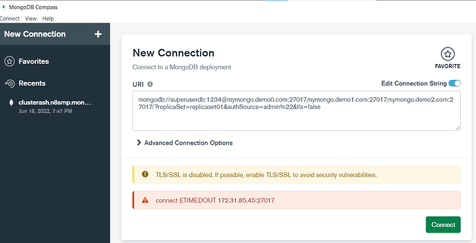

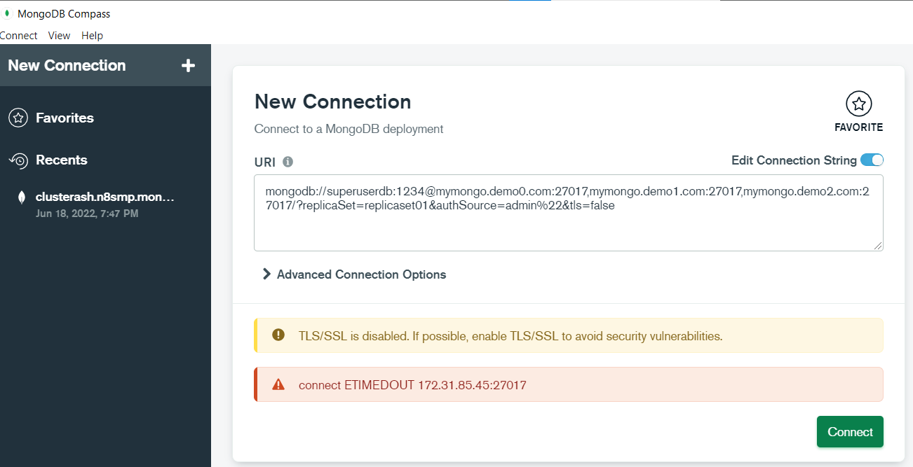

My RS with a 3 nodes is deploy on RedHat 8 .0 servers (using AWS cloud). Now I want to connect this cluster on Robomongo/MongoDB compass using Connection string (mongodb://Mysuperuserdb:1234@mymongo.demo0.com:27017,mymongo.demo1.com:27017,mymongo.demo2.com:27017/?replicaSet=replicaset01&authSource=admin")
I have install both MongoDB GUI tools on my personal laptop, I already configured my DNS into /etc/hosts file
See below connection string for Robomongo GUI tools
mongodb://superuserdb:1234@mymongo.demo0.com:27017,mymongo.demo1.com:27017,mymongo.demo2.com:27017/?replicaSet=replicaset01&authSource=admin

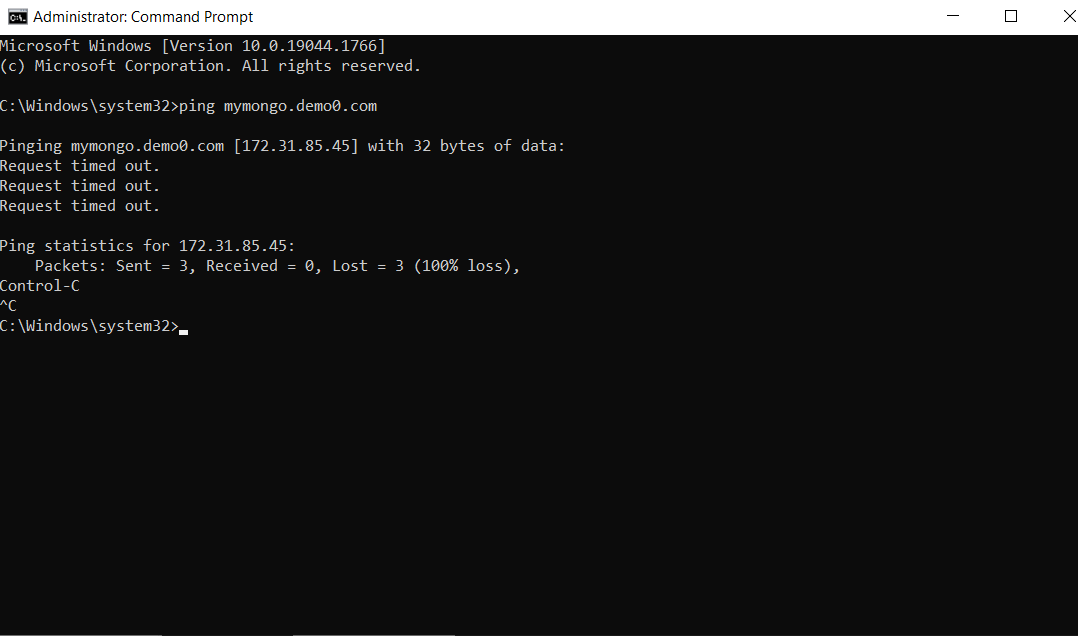

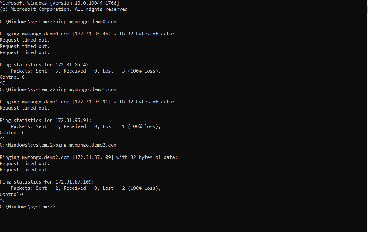

Can you ping mymongo.demo1.com and mymongo.demo2.com? Please post the output.

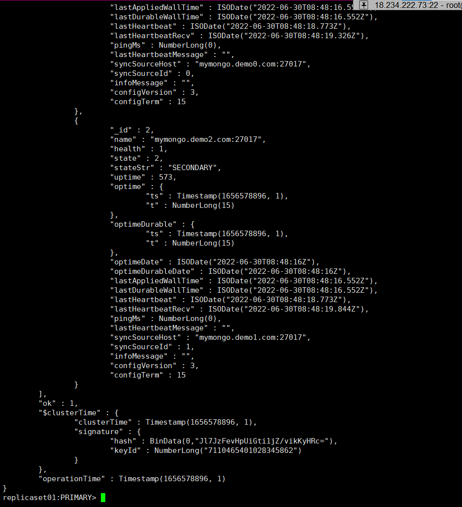

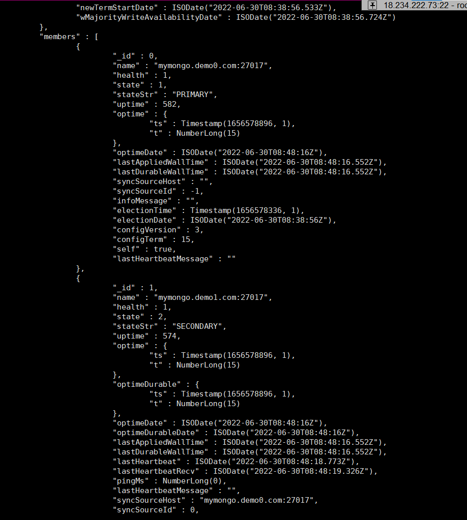

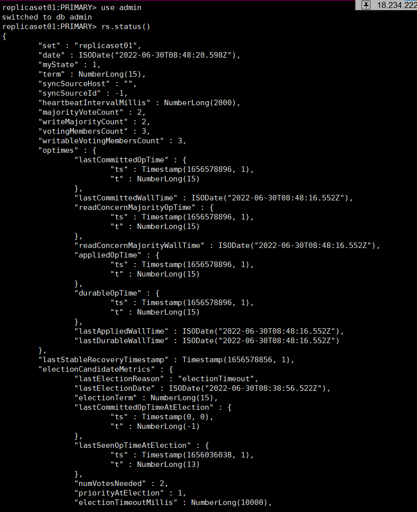

Can you share the output of rs.status()?

ping result of “mymongo.demo1.com” & " mymongo.demo2.com"

I have tried to connect one by one node but not able to connect on MongoDB Compass/Robomongo
Most likely your 172.31.85.0 Network is not properly routed from your workstation. You need to adjust your routing tables. If you do not know how to do that ask your system admin. If they do not know how to do that use Atlas.
Hi @Ashish_Wanjare,
The 10.* and 172.31.* IP addresses you are attempting to connect to are private network addresses that require you to be on the same local network or using a forwarding service (VPN or SSH) in order to connect.
Remote connection options are specific to your hosting configuration, but since you are connecting to a replica set deployment I would consider using an Azure VPN Gateway (perhaps Point-to-Site VPN from your laptop).
