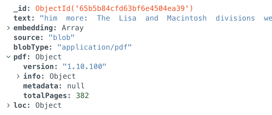

Not seeing this field in the Atlas Collection:
But I see it is returned in the query when the filter above is removed (which causes the error). (screenshot of a collection item)

I don’t see a field called “agenticDocId” in the sample document in the screenshot you included, is it cut off? I only see “text” “embedding” “source” “blobType” “pdf” and “loc”.
no it is. it
*it is not there
the field is not there

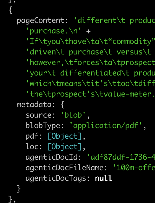

I can see that I am calling addDocument with this object which has the agenticDocId field
t:
but in the collection these fields are not present. They do not get inserted into the collection. Why is that? Here is a screenshot of mongodb compass:
They are inserted into Mongodb here:
In the example doc you show being inserted that seems like a completely different doc than the one you see in the atlas console? It has “pageContent” and “metadata” whereas the doc in atlas has “text” “embedding” etc…
Is it possible they are getting inserted into a different collection?
Are you sure that snippet where you are inserting documents is inserting the right things into the database?

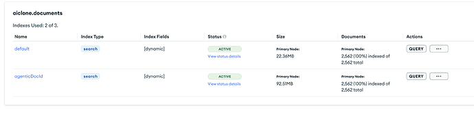

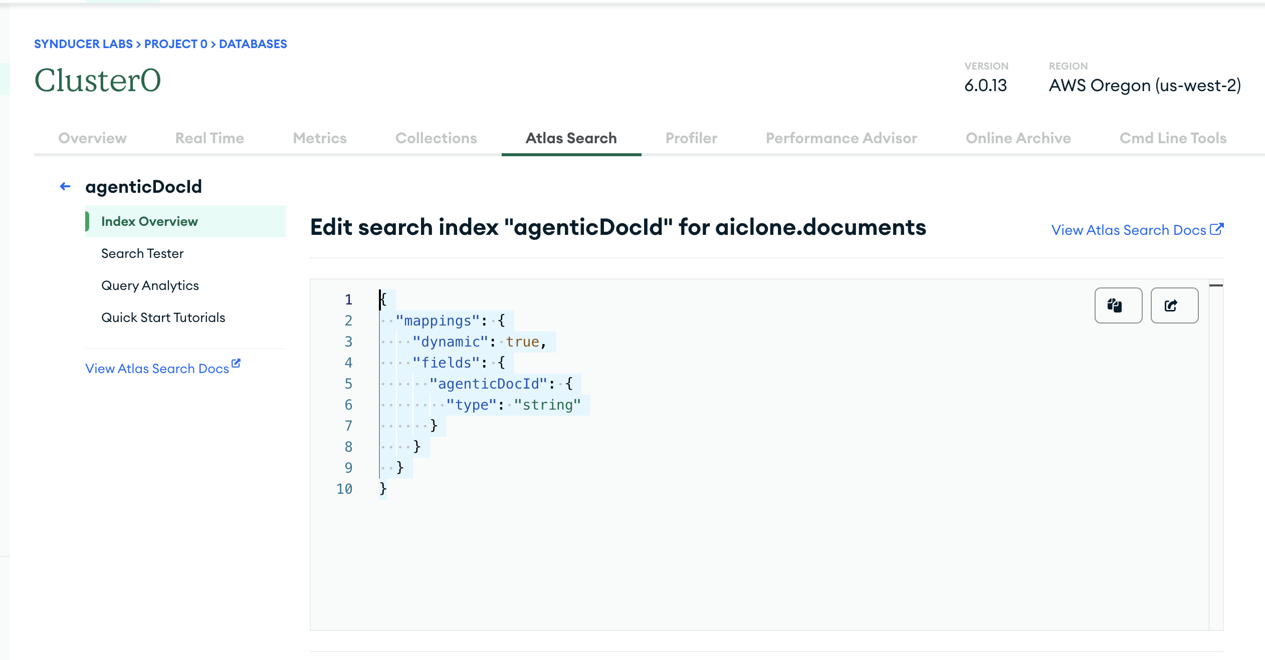

here is the search index ‘agenticDocId’:
and how it’s configured:
Please guide me on how to do preFilter. I have tried other syntax’s as well but got other kinds of errors:

I tried indexing it as ‘token’ field type, but same error appears.

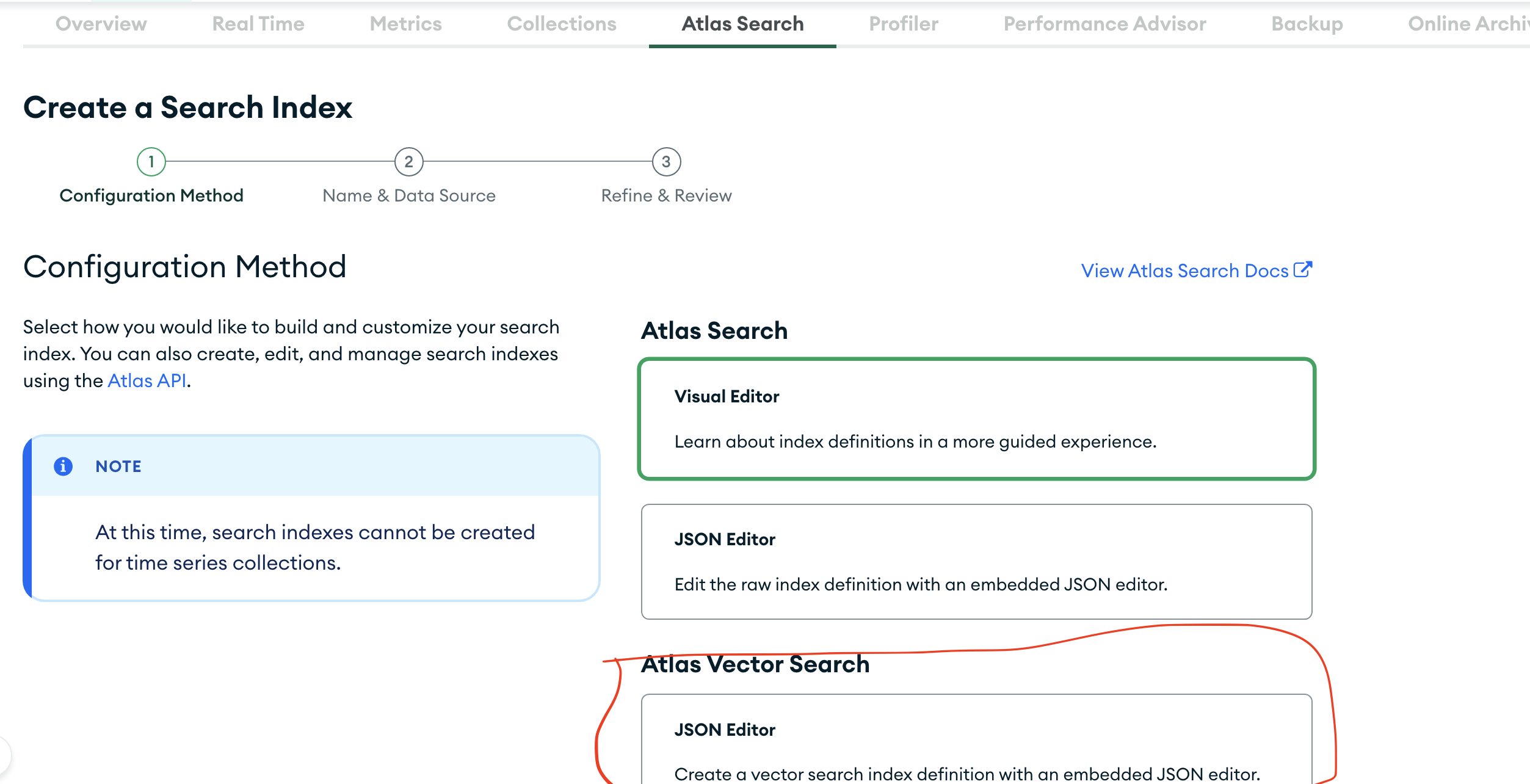

Hi @Konrad_Gnat , you are creating the index in ‘Atlas Search’ (which is full text search), while you should be creating one in ‘Atlas Vector Search’. this is what LangChain uses. If you click on the “Atlas Search” tab, it will show the following screen
In the Atlas Vector Search screen click on “Edit Json”:
Then enter the following definition:
