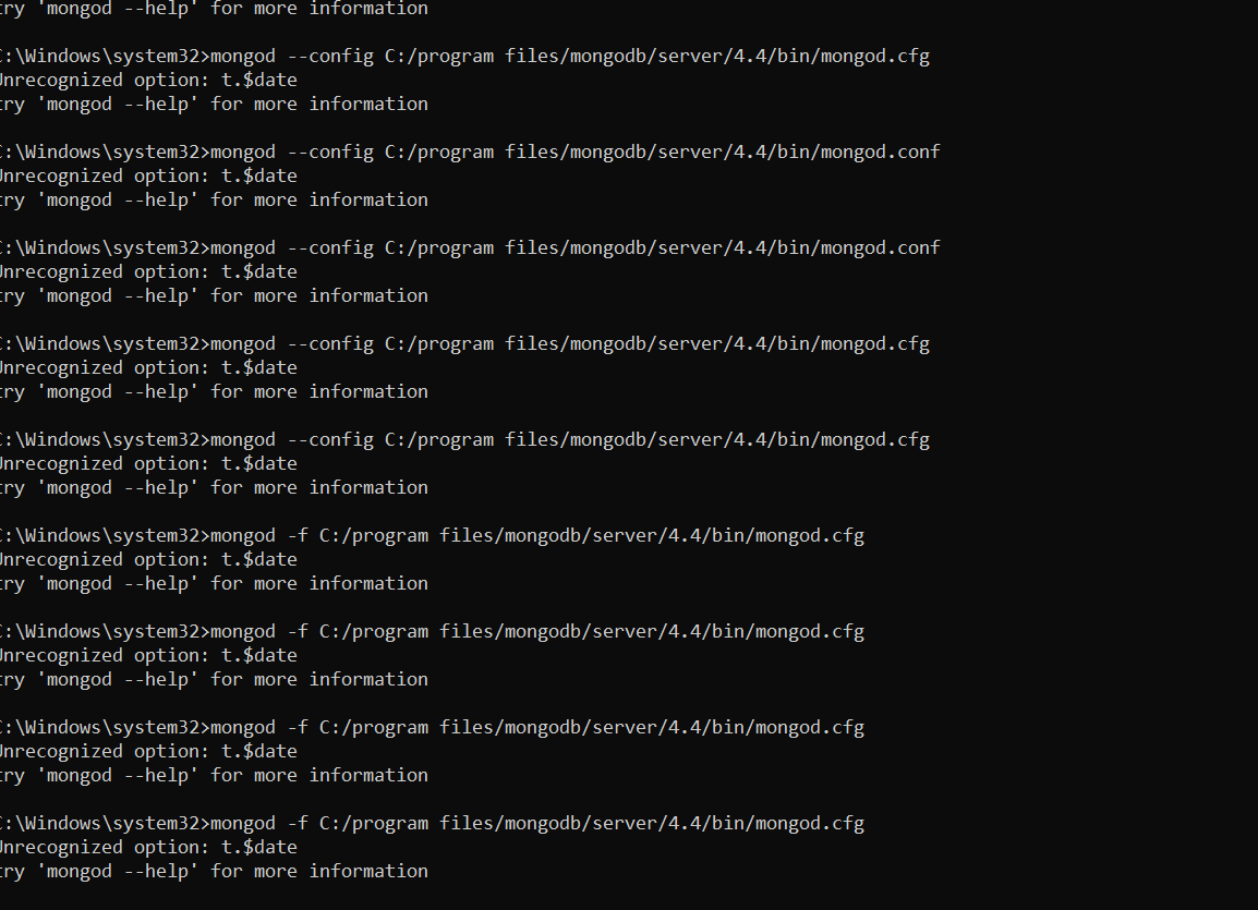

Now I have created config files for all three nodes. but not able to start even the first node using the config file.
I also tried different editing approach to resolve the issue like changing bindIP from 127.0.0.1 to my local system’s ip address 192.168.1.25
I am attaching a screenshot of my config file and the commands I used in CMD. In CMD you would also be able to see the error which is “Unrecognized option: t.$data”
It is not t.$data
Error says t.$date Check if you have used any other invalid parameter
Nice observation which make thinks that we do not have the whole picture about what is being done.
You wrote
but you show 1 configuration file that does not have any suffix or prefix that indicates that this is the configuration for replica set member 1, 2 or 3. The dbpath and systemlog.path also specify a general location rather than a member specific location.
You have an error that say t.$date while you write t.$data. But there is no presence of anything that looks like that in your configuration file. So, I suspect that mongod is a wrapper script around the real mongod command that tries to manipulate the single configuration file in order to generate member specific configuration. The error probably comes from your wrapper script.
This or we do not see the complete configuration file.
