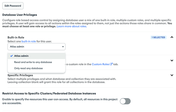

Hi @WONG_TUNG_TUNG
Have you tried setting up using the Atlas UI?
  1. You can access the Database Access from the side bar and then edit the access.
  2. Click on Add Database user and then add the built-in roles from the drop down menu.
attaching screenshot for reference:
Regards
Aasawari
